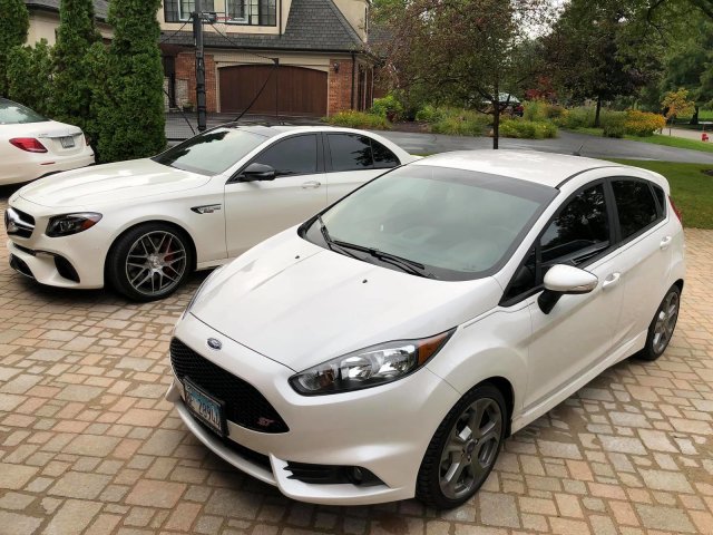

Hello Everyone,
My son just bought a 2019 FiST with 2000 miles. I've driven it a few times and I noticed that first gear is much more vibey than the other gears...it seems like the shifter moves and vibes a lot more in first gear than others. It doesn't do it all the time, it doesn't pop out of gear and it shifts great.
I called the dealer this morning but they cant get the car in for a week! Before scheduling the appt I wanted to inquire if this was normal?
We also plan to cobb tune the car later in the week and if it is not normal than we will wait to tune it before having the dealer inspect.
Please let me know. Car is awesome!
