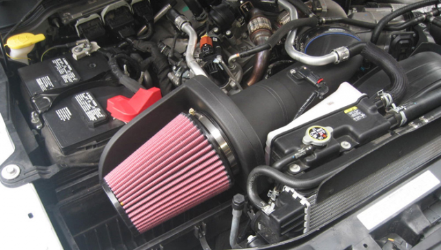

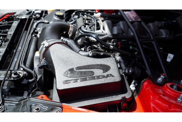

Hypergram
1,329
901
Orlando, FL, USA
Im not following with the intake part. What's an open filter intake vs non open (is my K&N CAI considered open filter?), and how can the intake affect heat soak? I get how on a hot day the ambient air heats up the IC faster than a cold day, but how does the intake differences affect it? I appreciate the info by the way.
Open Air Intake
Closed Air Intake
I'm 99% sure you have a closed intake.

Thread Starter #167
Open Air Intake
Closed Air Intake
Ah ok i got ya, the wording just threw me off. Yea so mine is referred to as a CAI AFAIK. It's technically open but it has a rubber wall gasket to seal it off from the hot side of the engine. Apparently it makes somewhat of a seal with the hood as it rests above the intake, and so most of the air is supposed to come from the wheel well below it (path of least resistance).
It's not a true CAI as i have understood them in the past, where you have your piping running all the way down and out of the actual engine bay. My guess was it's a cross between a CAI and SRI?

The engine bay is hot, the stock box is plastic and helps keep that heat from the intake air.
Are our engine bays too tight to run a typical CAI pipe all the way down and out? I figured a box might keep some hot air out but if it restricts air more, does it ultimately not have an advantage?
