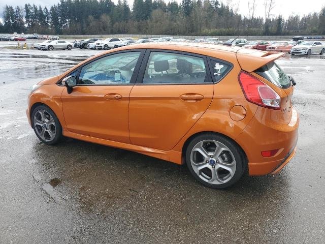

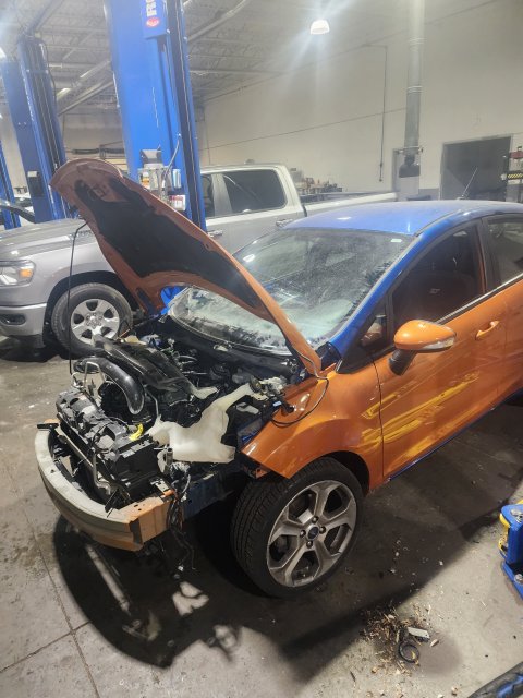

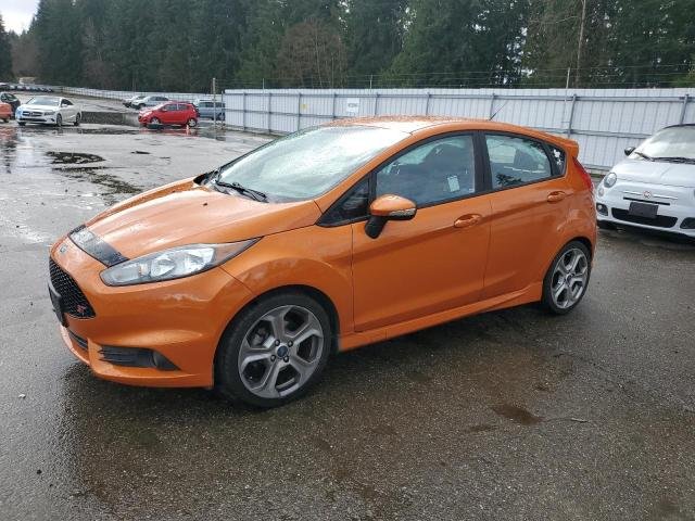

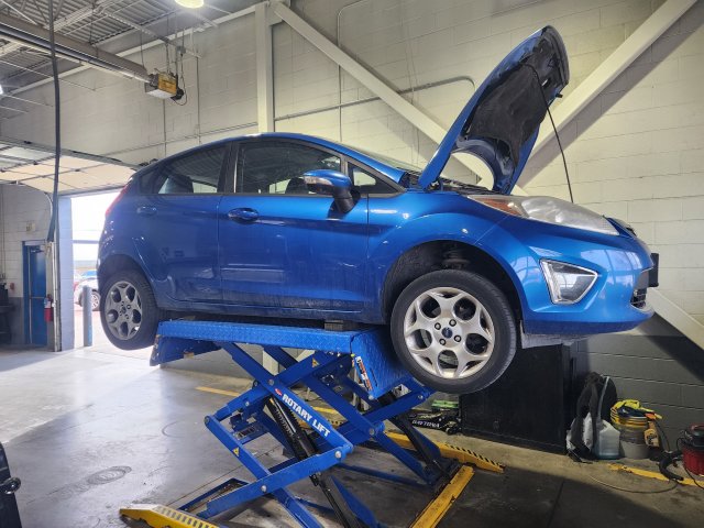

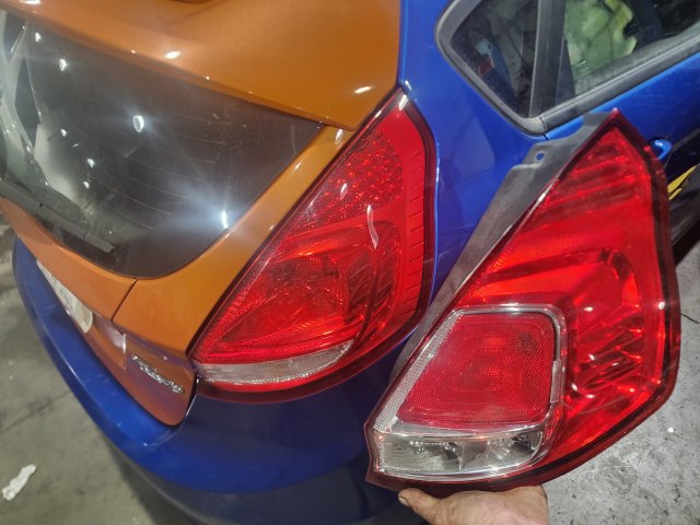

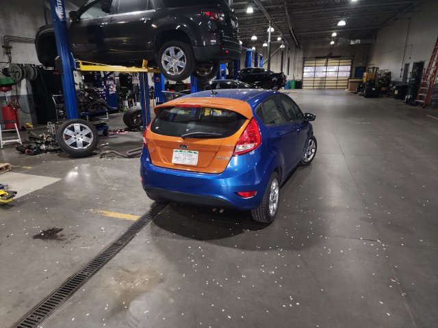

Got a 2011 SES for $600, its worn out with 160k miles. But the title is clean and the body is perfect. Then I got a salvage 2017 ST with 31k on it for $3200. Not a devastating side impact. I put a tire on it from the 2011 and it rips. Even has brand new oil in it. Someone loved that car. Interior is spotless. But the title is salvage and fixing it, branding it ect, na to much money. So here I am, a Ford tech by trade, that got bored on copart on day. Im guna FiST that SES into a fake ST. Bumpers, hood, fenders, driver side doors, passenger side handles, dash, everything is moving on over. Curious how long its going to take me. Going to do a wrap on it cause half blue half orange will be.... I just cant. Color for wrap ideas welcome. I do like this Orange.

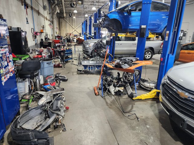

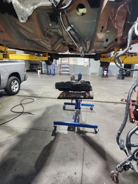

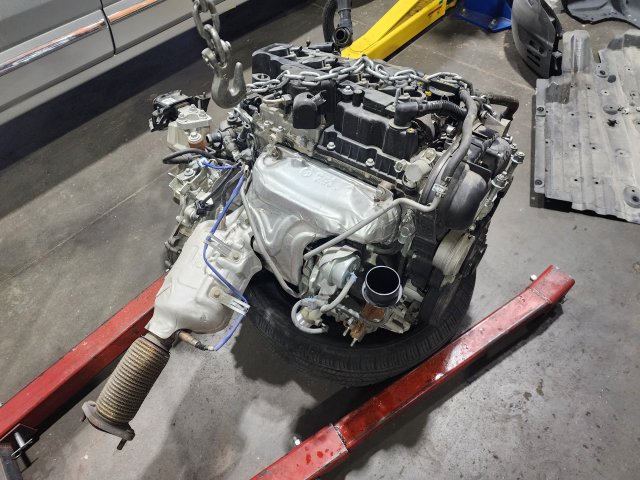

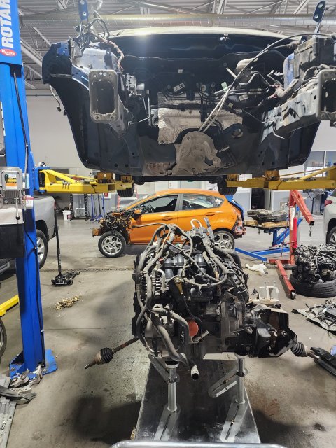

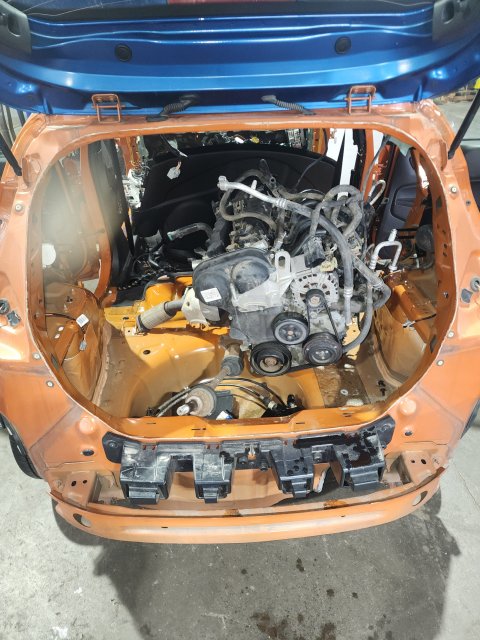

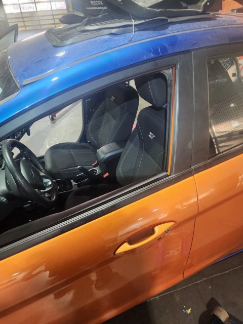

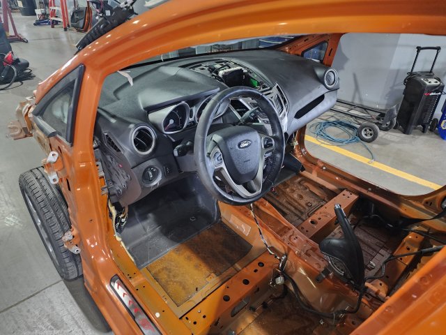

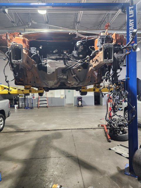

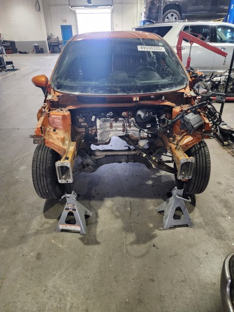

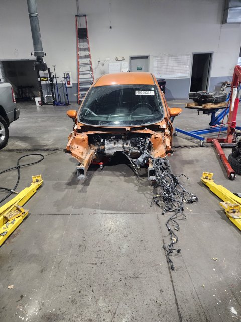

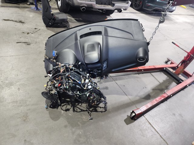

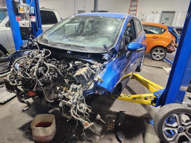

So I just got the ST home Monday. One of my bays has an acadia dead in it, I need to keep my lift open, and im not doing a swap on that scissor lift. Going to start with some body stuff Wed. Hatch swap, pull rear bumper and side skirts, headliner (easy cause curtains went off from impact), driver seat, ill pull passenger seat and take it home to takes it cover off for the sewing machine guy to stitch up, then go home. Ill swap the rear suspenson Thursday. Friday i want it get the engine/front subframe and suspension yanked pulled from the blue car/dropped on roller and push back. Saturday hope to rip the ecoboost out and get it all ripped out dropped and rolled out. sunday blue comes back in and in goes the st stuff until it rolls. Next week is the remining parts to get it fired up, pull and swap dashes and body harnesses really. I need fuel tank and lines..... what else?
