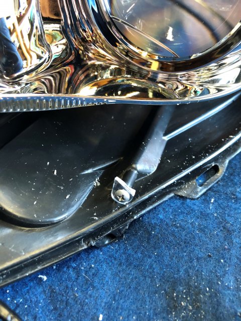

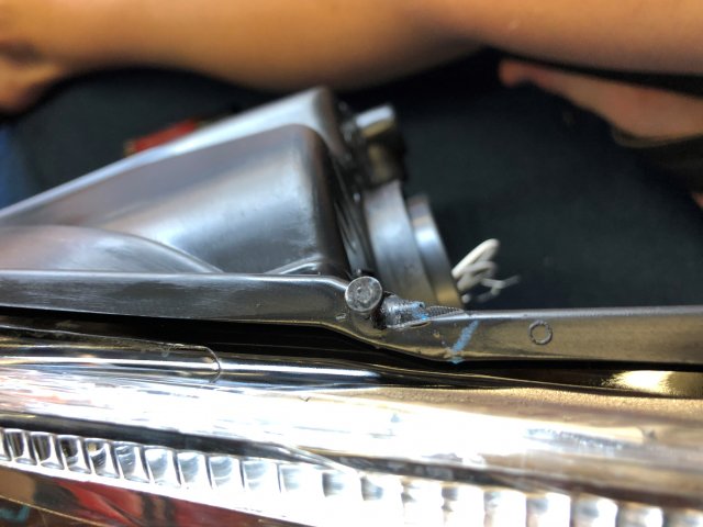

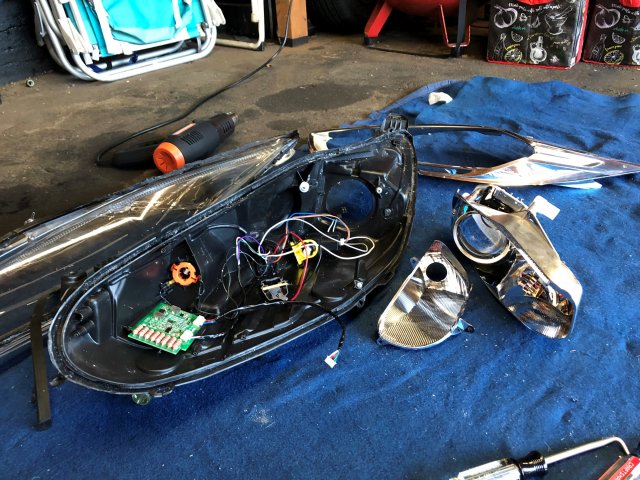

In this first installment I have separated the lens from just one of the headlights so far. Since our headlights don't fit in an oven (conventional home size) we're stuck using a heat gun. Getting this first lens off took me two sittings, about 2 hours each. I work slow and on this first one it was my learning time. I still managed to break one of the tabs that mounts the LED strip assembly to the main housing. I think the reason for this is that the LED also mounts to the outer shroud piece, and this shroud has tabs that are sandwhiched between the lens and the housing, so pulling the lens off, the shroud piece came with it. I'll be more careful on the 2nd one and try to get a screw driver in there and pull the screws out first.
The first step for pulling the lenses off on the Depo headlights is pulling the pins out shown in the 3rd pic, there are 3 of these around the edge of the housing. Just focus your heat around them, them pull them out. Then its just a slow process of heating areas and working on separating. I used an awl, and would just scrape out as much sealant as I could. Then when it seemed like it was good, I spent more time working the heat gun around the entire perimeter and started pulling it off.

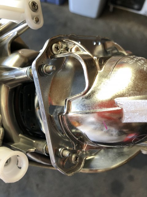

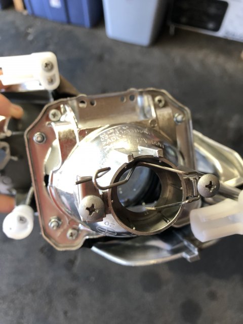

The stock projectors mount to the projector shroud which is all one piece with the hi-beam reflector. Ill take a close up pic of that portion later today
New_Daily
436
409
Simi Valley, CA, USA
This is how they mount. This is the combo hi-beam reflector / projector shroud. They mount directly to this which in turn mounts to the housing via the large ball end mounts one being the leveling motor and the manual adjuster.
