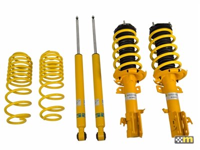

If the spring is symmetrical and the distance between the compression coils is constant the spring is linear.

From the looks of them, one pair is linear and the other is progressive.

Would you mind explaining your conclusion?
In the photograph of the springs, the front coil distances appear to be consistent throughout, thus it appears that the fronts are linear, whereas the rear coils clearly appear to vary greatly in distance, thus it appears that the rears are progressive.

The MountuneUSA springs ARE linear. When installed, the short coils are fully compressed so they are “dead”. I’ve run them for years on my old 2014. I made me some spacers to insert into the dead coils to adjust ride height. Facts.

Well technically we are both right. As since uncompressed how they are wound is whats known in the spring world as a progressive wind.
Now because they compress and go dead then they may act linear.
Fact is its a poor design spring wise because of that in my opinion as the dead coils just turn into excess weight. Swift actually points these kind of poor spring designs out on their page. Less excess winds equals lighter weight and better utilization in my opinion.

Fronts are linear and rears are progressive as per photos on the website. We will only know for sure when someone posts a photo of them

#20
You can see both springs have a constant distance between the compression springs. This means they are linear
