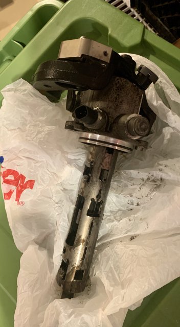

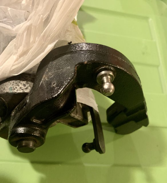

It’s not the easiest to do. I had to do it when i installed the coolerworx. I removed the whole shift assembly from the transmission. Carefully put it in a vice and used the mountune pin removal tool and a dead blow hammer to get the stock pin back in the shifter assembly. If you are parting out the car, I would probably just leave it on and let the next owner have it. Not really worth the trouble. Here are a couple pics before and after. Doesn’t really help but it is possible to do. Just depends on how much work you feel like doing. Feel free to pm me if you have any questions.
