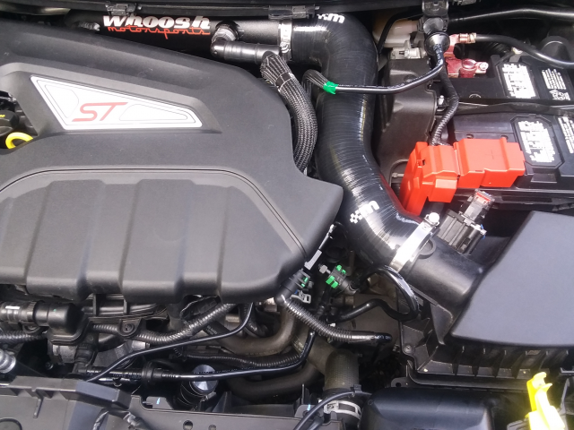

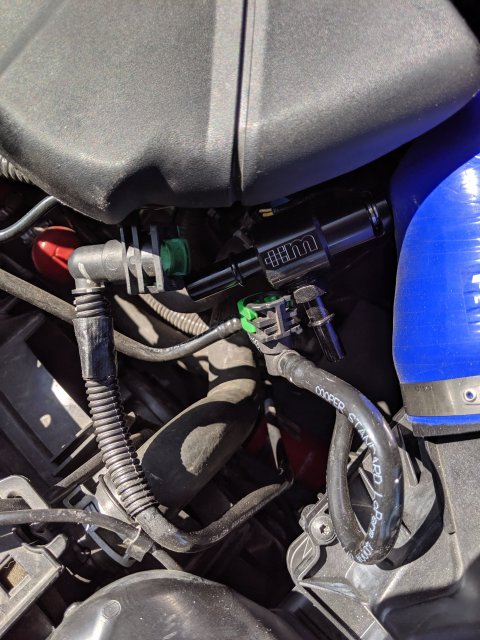

It was an absolute beast to get installed, I had to spray my Whoosh cerakoted crossover with soapy water to slip 'er on but finally got it on there about 1.5" of engagement, so I can safely tighten the hose clamp. Now that the soapy water dried it is pretty well locked on there.
FIRST - sorry for how dirty my engine bay is, I haven't cleaned it thoroughly in a few days.
Here's where the mountune clippy.... "thing" sits in relation to where the hard-lines naturally want to wind up:
Here's how they sit when connected:

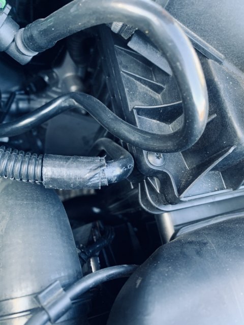

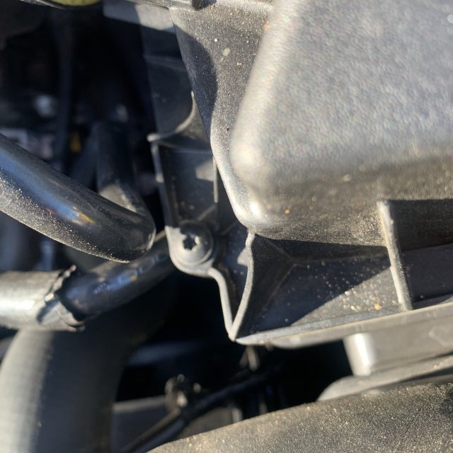

The left-side to intercooler hard line rests against the airbox, after driving ~20 miles it's already rubbed a shiny spot. Probably won't matter if I get a different intake/box, but for right now it rubs.
Anyone that's installed one of these, does that look about right? I don't see that there's a lot of adjustment to do to make the mountune 1-2 thingy for the 2016+ sit differently.

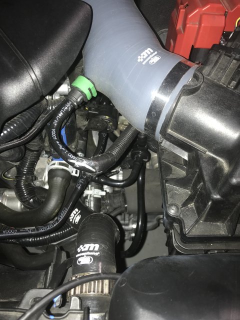

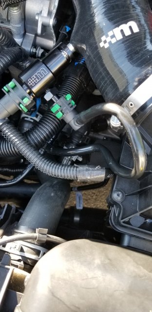

This is how mine are sitting. The evap hose on the right is just barely not touching my intake, but very close. IMG_20190829_100801.jpg MVIMG_20190829_100819.jpg

This is how mine are sitting. The evap hose on the right is just barely not touching my intake, but very close. View attachment 23164 View attachment 23165
Ok so it looks like your left-most one rests on the airbox, too. Maybe it's normal. I'll see if I can't contact mountune customer support just for clarification.

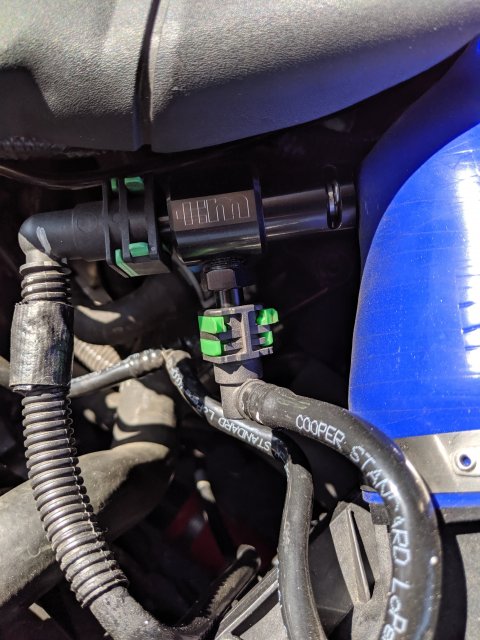

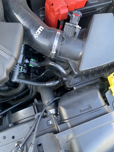

B96BDF42-2DA6-4E3D-A6D9-02715188C90C.jpeg I first tried the MountuneUSA induction hose, but have found the MountuneUK SAMCO hose fits better. The SAMCO has more of a factory fit and feel to it. It was much easier to install. I also think the older evap line looks cleaner with less hose under the hood. I’m curious why Ford changed the design, was it a factor of cost? With all that said I would buy the MountuneUSA adaptor, but they don’t sell it separate.
