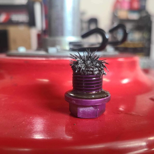

Yea I’d say change the transmission fluid and engine oil. Install magnetic drain plugs if you haven’t already and see if there’s metal pieces in there. Listen for noises but you may be alright.

Ordered some fluid and magnetic drain plug from whoosh. Should I get one of those little cameras to take a look inside when I change the fluid?
