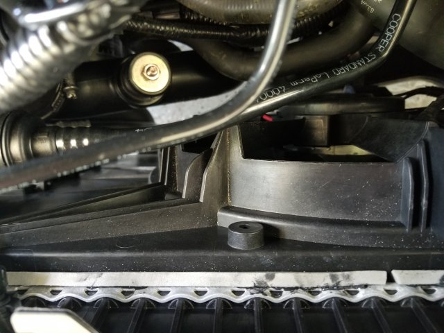

using regular 1" tall 1/2" width home depot foam and black rtv as the "glue"
Thanks man! I would likely do that for sure but I already have a Mishimoto clone radiator waiting to go in and since that is obviously thicker I'll have to see how much gap is left after install... And the thing is, is that this clone did not include the new fan bracket the actual Mishimoto includes (and can't buy separately) and have no idea if the stock one will work with some modifications, ugh... But for noobs, this is nearly a must do, you need to help the stock radiator all you can, which is barely larger than a regular non-ST Fiesta. Also, despite what some people claim, if you only use HALF the bottle as instructed for our stock cooling capacity, dropping from a 50/50 coolant water mix to only 30% coolant and half bottle of Water Wetter definitely helps too. You still get freeze protection down close to 0F, so for those who have really cold winters and still drive their FiST during that time will need to bring that ratio back up, but likely wouldn't apply to many people.

For your #7 foam tape thing, can you describe it better where t tape or have pics? I really want to try this! I'm also considering cutting the excess flaps and crap off the fan shroud itself too.
Yeah, I'm looking at sealing gaps between the rad and fan shroud also, Take a look at the thread from @shawn36 and the pics he posted:

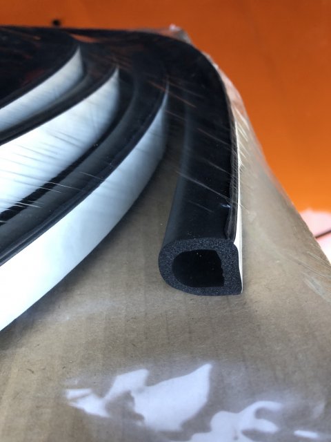

I'm looking to do it a little different when I do my Mountune rad install, especially on the sides. I think I'm going to get some D rubber seal and put it on the inside of the fan shroud, at least for the sides. It may need to be on top for the top. Here's the seal I'm probably going to get
https://www.grainger.com/product/TRIM-LOK-INC-Rubber-Seal-48RM46
It's expensive and I certainly don't need 25' but they won't sell by the foot. You can find smaller for much cheaper, but in looking at the pics on the above link it looks like there's at least a 1" gap from the inside surface of the shroud and the rad.

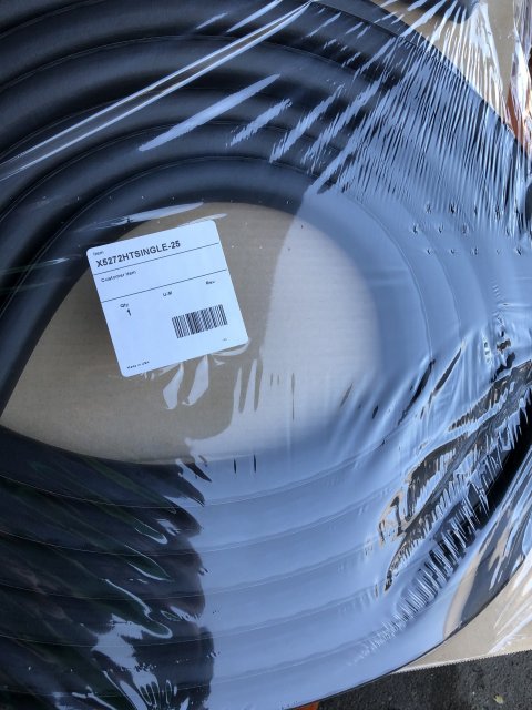

Just ordered the roll from the link above. After tax and shipping it was $70 :rolleyes::rolleyes: Whaaaaaaatever. Spent the money on the Mountune rad, might as well do everything to maximize the performance of the system and only do the job once while installing the rad.

$70 for tape? i think thats way overboard...why not just use the $4 door edge foam from home depot...i had it on my sentra right next to the turbo...man it was so hot you couldnt touch it...but it lived there till i blew the head gasket - 60k miles...
$70 sealant tape...no need for that.

Foam looks like shit and I want to do a quality job that looks The part as well as it performs.
It was expensive mostly cause 25ft is the least amount I could buy and they charged $13 for shipping (which was hilarious, a box that the seal fit at the bottom then it was about 1.5’ tall 🙄). If I had been able to buy maybe 8 ish ft it would have been a much better price.
But when I’m done I know it will last. The rubber is the same stuff the coolant hoses are made out of. And I’ll be happy with how it looks and performs.

nobody will see it so how it looks is really irrelevant. to take that picture I had to lean way over and focus inward...it is normally not seen

You can see the OEM foam around the radiator which will all be replaced on the new rad as well as added between the rad and fan shroud. Also, rubber seal works better than foam.

As noted, what I got was rubber not foam. Rubber is better than foam in both performance and looks.
