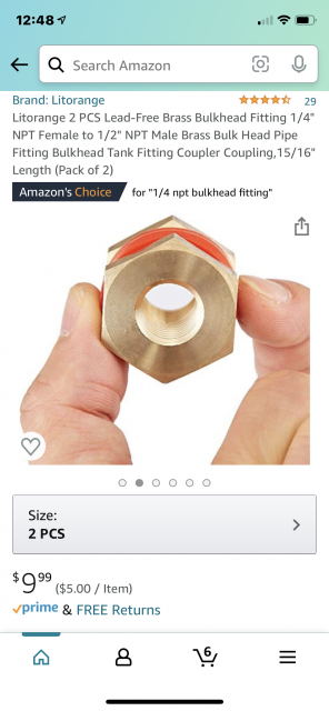

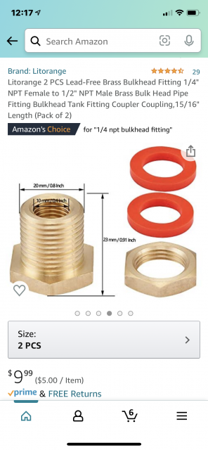

Well if the whoosh one dosent fit it looks like neither will, since the CPE one has a bigger ID. I’m thinking of buying this and using it as a port on the stock pipe.

I wonder what the size diffrence is between the cpe exhale kit and the MethCharge pipe. They look pretty identical except for the bov bung. This may work, and if it does I’ll happily pick up the pipe. I’d rather do that than go with the diy bung, hopefully he can confirm it fit.
