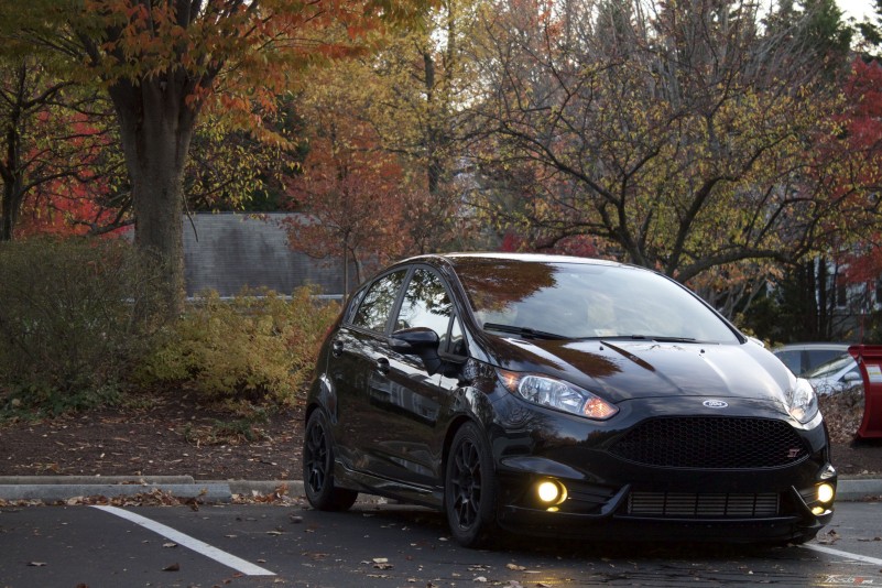

And I've tried to get a hold of him but anybody airjor13's wheel and tire setup in this photo? I know I've probably asked him before but I forget often :X

I don't have an answer but that car is menacing!!! Makes me almost wish I had gotten black, though with this drought I would have gone crazy not being able to wash the car as much as dark-colored cars need.

Exactly why I want the specs. Haha. Want to look like that. Have everything but the stance. I think he's lowered though which I'm debating being in the city and all unfortunately

Hey guys, sorry for the delay. Kip, in that photo 15X6.5 Sparco on 195/60R15 Hankook on H&R springs, no rubbing, combined weight around 34 lbs wheel + tire!

Thanks. Is that the same set up as the first picture in the first post of this thread?
And you plan on going wider any time soon?

No, the first pic in the thread is like 205/60, I do not recommend it. I might go wider if I can find some 16X7 or 8 that I like.

[MENTION=382]airjor13[/MENTION] need moar pics. the 60 height is surprising. I assume your speedo is quite a bit off from actuality as I believe 50 would be the correct size?

60 is definitely not recommended, made the gearing taller, sluggish acceleration. 195/55R15 is perfect rolling diameter, same as stock.
