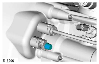

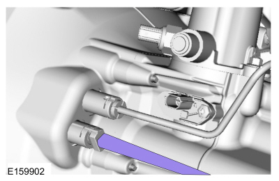

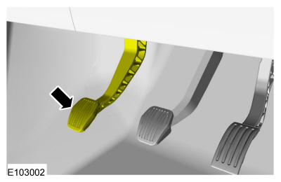

Clutch System Bleeding
WARNING: Before beginning any service procedure in this section, refer to Safety Warnings in section 100-00 General Information. Failure to follow this instruction may result in serious personal injury.
  • Refer to: Health and Safety Precautions (100-00 General Information, Description and Operation).
    Refer to: Brake and Clutch Systems Health and Safety Precautions (100-00 General Information, Description and Operation).

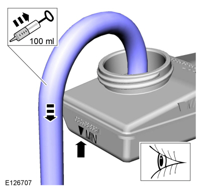

  • NOTE: Make sure that the brake fluid level does not drop below the MIN mark.
  • If equipped.
  • Install the following items:

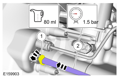

    • General Equipment : Brake/Clutch System Pressure Bleeder/Filler
    • If equipped.
    • Refer to: Specifications (206-00 Brake System - General Information, Specifications).
    • If equipped.
    • Remove the following items:
    • If equipped.

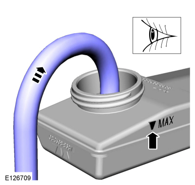

    • In order to remove any small amounts of trapped air remaining in the system, operate the clutch pedal 5 times, using the full clutch pedal travel.
    • NOTICE: Make sure that fluid level is to the MAX mark.
      Material : Motorcraft® DOT 4 LV High Performance Motor Vehicle Brake Fluid/PM-20(WSS-M6C65-A2) (ISO 4925 Class 6)

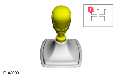

    • Start the engine.
    • Check the operation of the clutch. If reverse gear engagement is excessively noisy, operate the clutch pedal 5 times, using the full clutch pedal travel.
    • After waiting approximately 30 seconds, check the operation of the clutch again. If reverse gear engagement is still excessively noisy, repeat the bleeding procedure.
