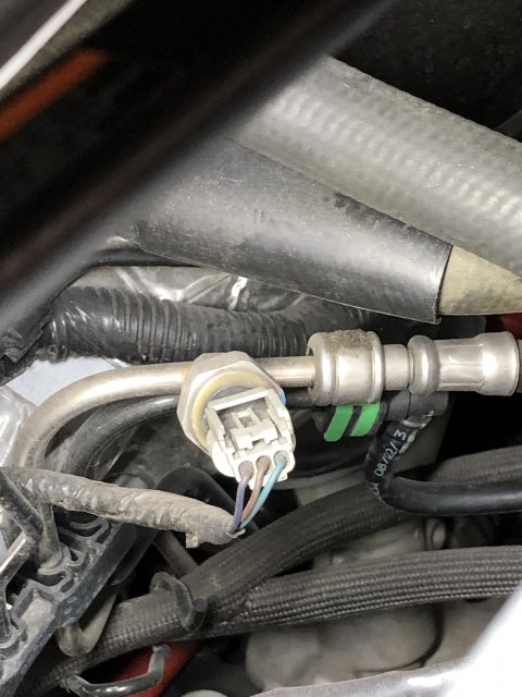

@TyphoonFiST did you relieve the fuel pressure before removing the sensor? I’m about to attempt this today. I gotta remove the cowl and/or induction hose to get to it though. I still haven’t been able to locate it back there.

Ok cool. Since the time I posted, I managed to remove both cowls and induction hose to get a better view. Is this it?
