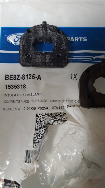

Rubber Insulator Part #: BE8Z8125A $11.17/each. You need 2.

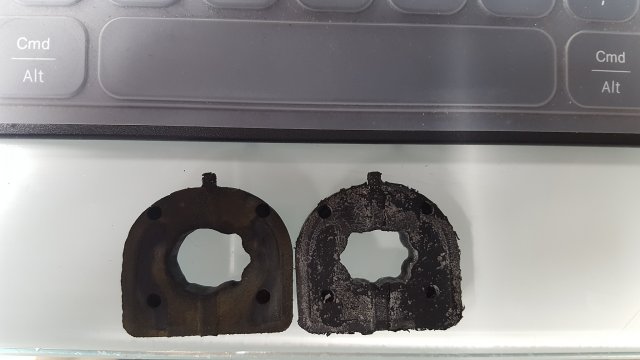

Old left - New right

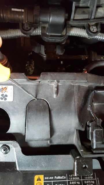

Cover pops off towards the front

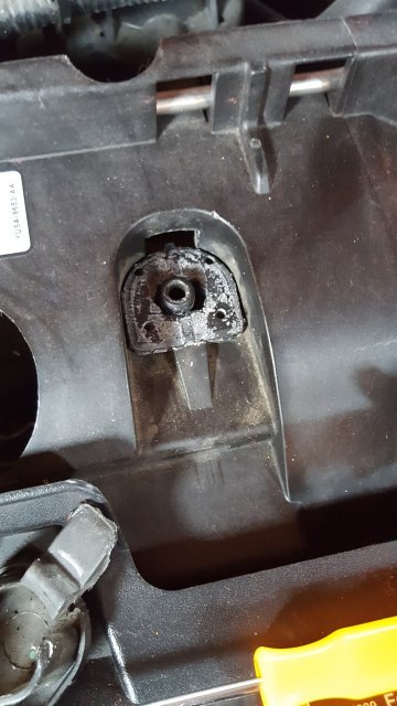

Replace insulator
Same for left/right. Pop the covers back on and there is very minimal radiator movement now.
