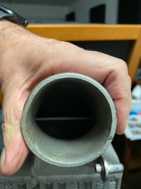

they are regular end tanks, below is a pic of a Delta fin end tank View attachment 38782
Got it, I’ve never seen them referred to as delta fin end tanks. Just always have seen “divided end tanks” or “Air Dividing end tanks” I appreciate you clearing it up.

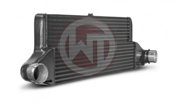

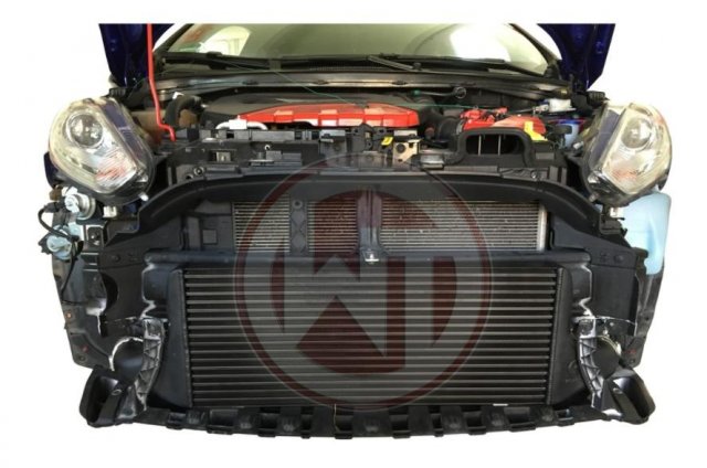

In reply to @SST ya Wagners are dope I think Ron has them on his site they are very expensive though. Also one does not need a Wagner unless they are shooting for big HP numbers IMO.
