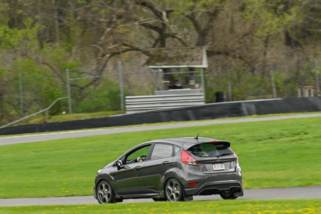

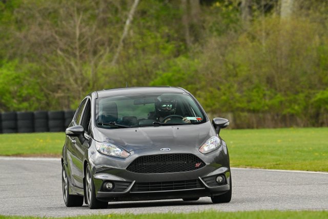

Some photos from the event. Overall a great trial for the car but only ended up getting one session in due to the car running hot 15 minutes into the first session. I took a couple of laps to cool it down, first lap back out, the hot side S pipe blew off the intercooler. I tried to put it back on but the OEM clamps wouldn't hold. Ron had my money for the upgraded S pipe before I left the paddock.
Upgrades before the next event
-Mountune Radiator
-Whoosh S pipe
-Pierce 6 Point Lower Brace FB4279AC-F602-4CB3-9D16-E5386CF8CB25.jpeg F8326670-2685-419E-9D1D-52E769AA0552.jpeg
