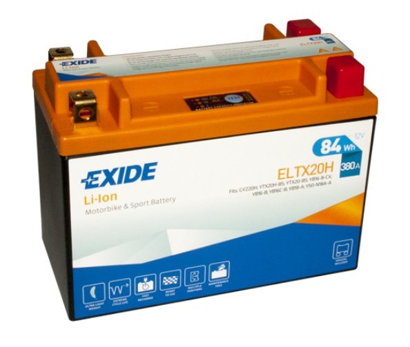

I decided to search for a lithium alternative and found the ELTX20H from EXIDE
Battery capacity 7.0 Ah
Battery CCA 380.0 A
Battery layout L+
Battery energy 84.0 Wh
Battery weight 3.7 pounds
Is anyone using such a small / or lightweight battery such as this one?
I have read somewhere (dont know if its true) that there may be power loss when fitting such a small battery? Is that even possible?

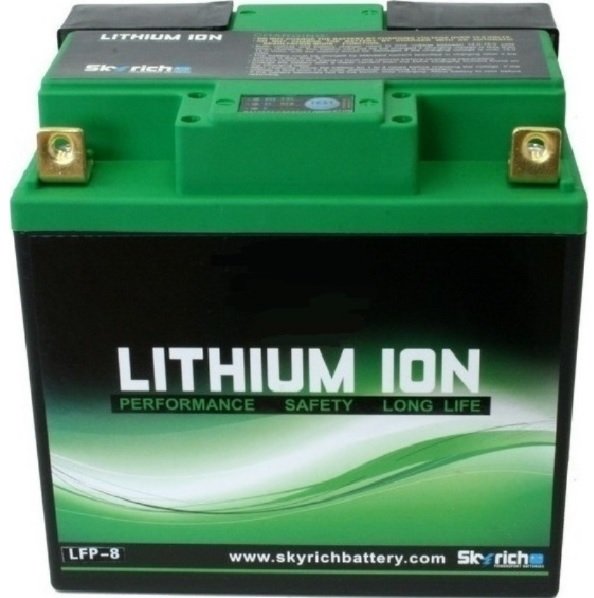

Skyrich LFP-8
Battery capacity 8.0 Ah
Battery CCA 480.0 A

the primary use of the exide seems to be for HARLEY DAVIDSON FXST and HONDA VF 1100/1340

Id find the lightest battery with the most CCA available. The 480CCA in the Skyrich LFP-8 is an interesting one as its 100cca more than the PC680 and much closer to the factory OE CCA rating. Ive never had good luck with the PC680's. They are just too small for todays engines to last longer than a year under any circumstances.
With that, my factory OE battery is going on 6 years without a single issue(which i just jinxed myself).
