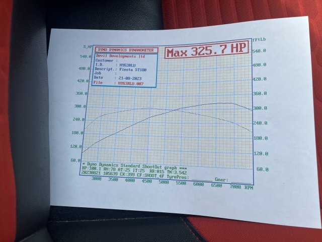

It made 336hp on the last dyno run, although it had the stock catback at the time

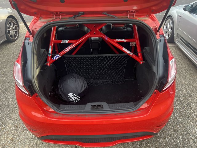

Love to see the car getting used. Any pics on the false floor? Curious to the look of it.
Sure! The floor is plywood with carpet stapled in. There's sound deadening underneath so it's not much louder than having the rear seats in.

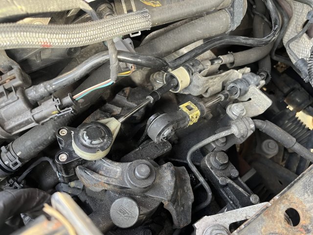

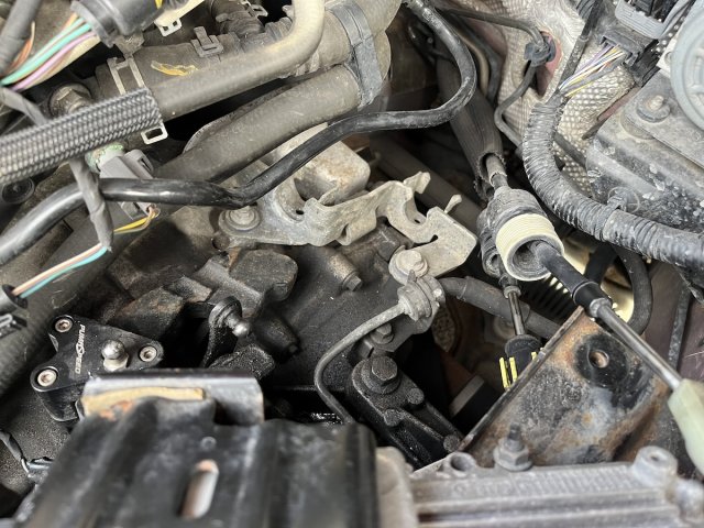

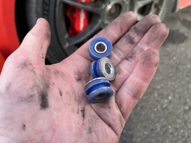

In the meantime I've done some boring jobs. First off was installing solid shifter bushings - this took about 30 minutes and wasn't much hassle.
This is the bracket that needs to be removed, it's held in by 3 x 10mm bolts:
I didn't realise until I'd removed the bracket, but the OEM bushes look to be polyurethane:
Bracket reinstalled with the solid bushes:
After refitting I'm not sure there's any difference. But for £25 and 30 minutes time it's not the end of the world.

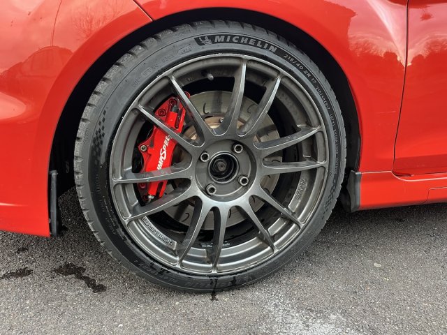

I also replaced my street tires with PilotSport 5's in 215/40/17. There's no rubbing at all, although I suspect going any wider would. I also replaced all the pads - the fronts are Pumaspeed racing pads, and the rears are PBS:

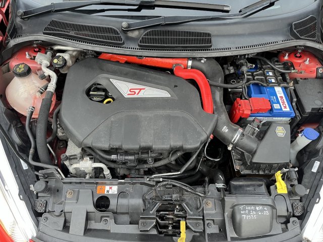

Lastly, and most boringly, the OEM battery finally died after 11 years, so in goes a Bosch replacement:

@Woods247 and @M-Sport I got the wheels from Pumaspeed (link here) as they were guaranteed to clear the front brakes. They’re pretty reasonably priced over here and fit the Fist perfectly. They’re rebranded Rays wheels from what I can tell - 17x7.5 ET38.

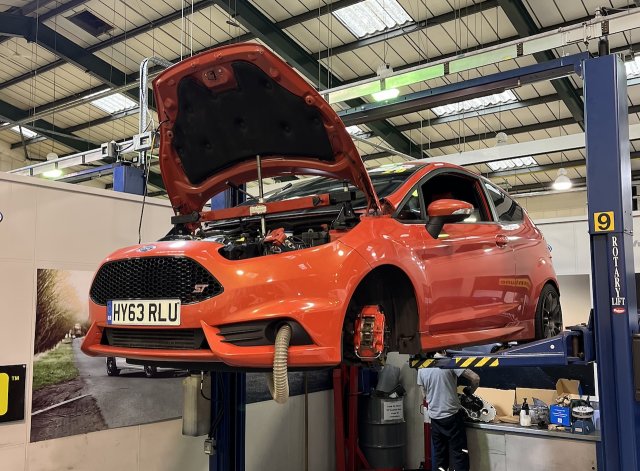

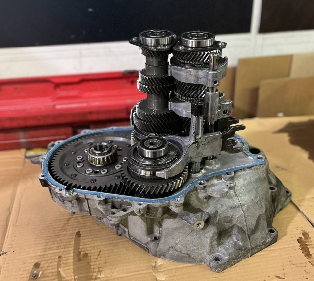

Dropped my car off at Mountune HQ this morning for the LSD installation. Their showroom was crazy! Full of built engines, carbon fibre and race sims. I received an email later in the day with some photos of the progress. The guys at Mountune are amazing, can't recommend them enough - the service and comms are next level. I'll be taking the train to collect it tomorrow.

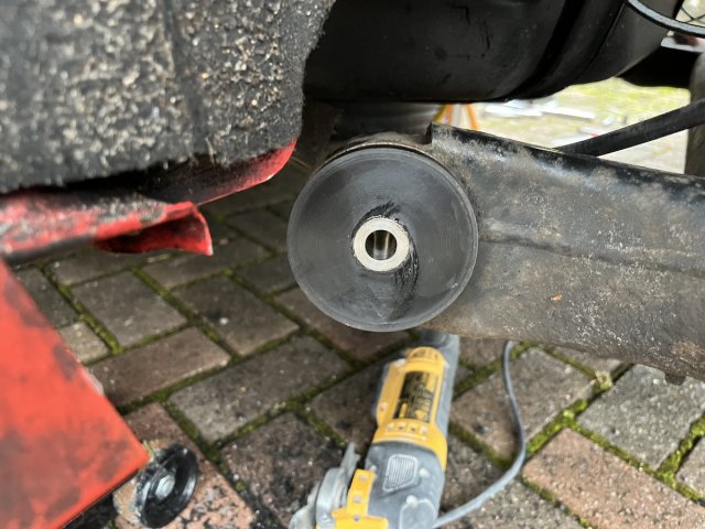

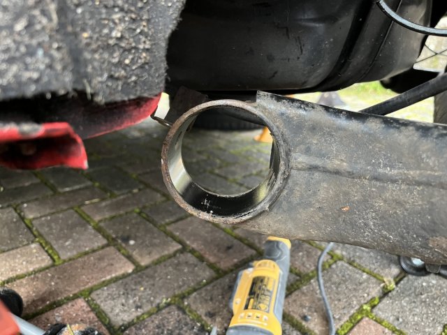

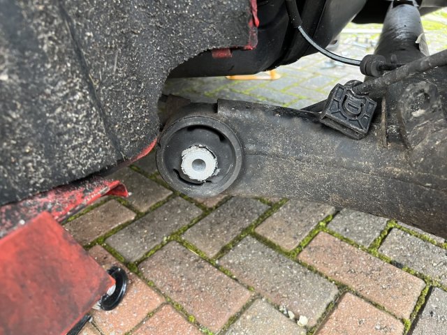

Today I swapped the rear beam bushes over to Powerflex black series.
Here's the old ones. I'm not sure if these are in good or bad shape for 11 years as I have no reference:
Getting the old ones out was a massive pain in the arse. I tried to use a press but failed. Ended up cutting them out with a multi tool. Here they are removed before I cleaned everything up:
Finally, new bushes installed:
First impressions are good. The rear feels less bouncy than before, and the ride quality does not seem any worse than the MeisterR coilovers already make it.

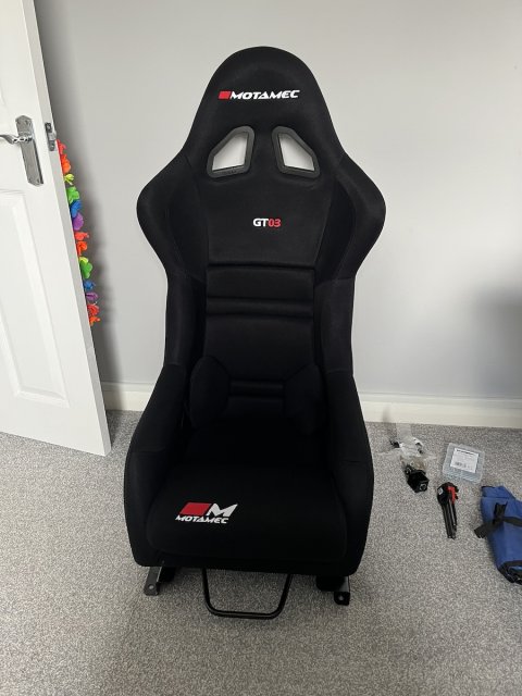

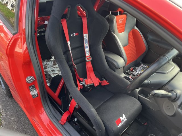

Finally got round to ordering a seat, went with a Motamec GT03:
However, I had an absolute disaster trying to fit it. First off, having sliders made the whole thing sit so high that my head touched the roof, so they had to go. Next problem was that the seat sits so far forward that I couldn't even get in the car. I'm not massively tall at 6"1, but this was crazy.
Here's the seat loosely installed while the sliders were still installed:
Without the sliders it sits at an okay height, however the whole assembly needs to sit about 10 inches back. I can't think of any way that I could get this to work without making some custom subframes that allow me to mount the side mounts a lot further back. The factory mounting mounting points seem like they're too far forward.
lemonjs
72
136
United Kingdom

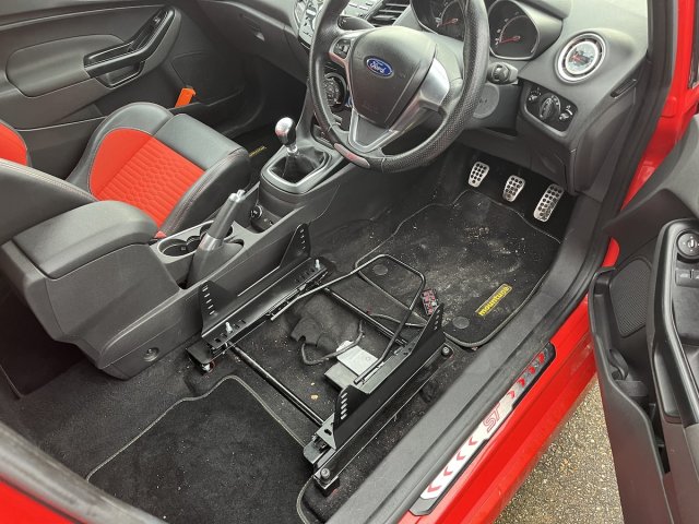

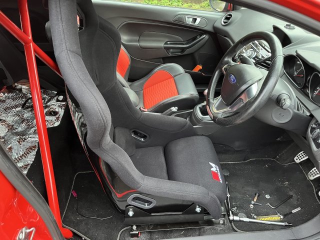

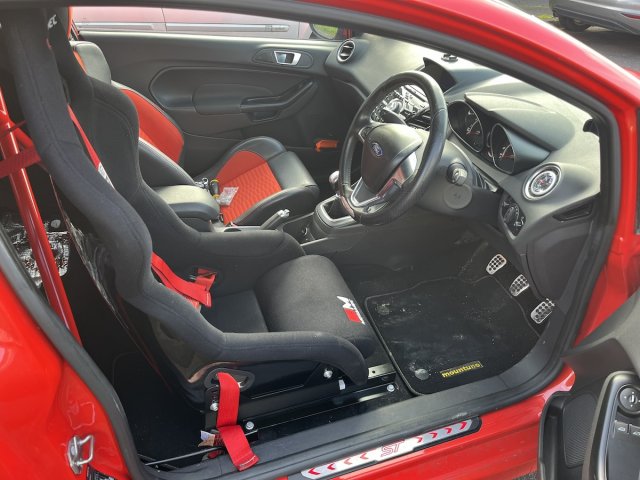

Thread Starter #20
Finally got round to fitting the seat. I ended up ditching the sliders and drilling some new holes. I've fitted a 4 point harness and used a 2.2ohm resistor to keep the airbag light away. I'm going to remove the original seat belt when I get time, although this looks like it will be difficult with the cage in the way.
Counting down the weeks to the first track day of the year!
