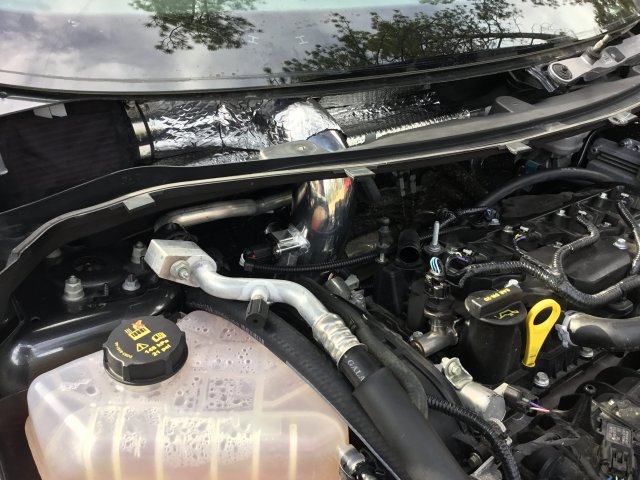

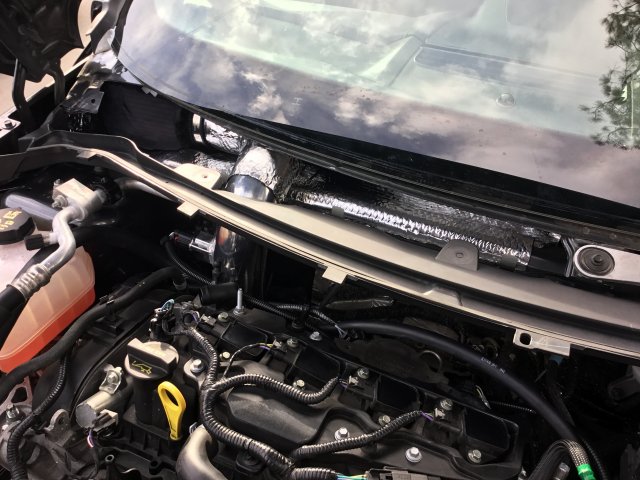

I installed some adhesive sound dampening material which eliminated any knocks or rattles and greatly reduced the intake noise.
View attachment 20362 View attachment 20363
I added some strips but I was hesitant to blanket the whole thing. Maybe in the future after i get a spare cowl. Is standard fiesta cowl the same?
I wish the 2j attached to the bolts that hold the crossover to mitigate vibes a bit. The real concern was, everywhere I heard contact is a wear point and I’ve had an aluminum intake wear thru before resulting in the engine sucking in aluminum dust. I’m about to have a hand surgery and won’t be able to pull the cowl for months, so the smart move is back to something easier until I’m physically able to give myself that peace of mind. I think it’d be fine, but peace of mind is a powerful thing.
I gave our second daughter our 2012Fiesta SES. When I see her next time, I’ll see if the cowls appear similar.
