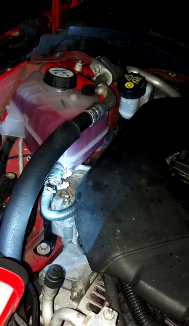

2014 fiesta ST thermo replaced but still overheating. Have noticed on a "gentle drive" it is PISSING out coolant just behind the overflow coolant reservoir. Thermostat opening at 97 degrees.
It's been bled and what not - I'm at my end with this car. Trying to organise getting it into mechanic again but not sure if I'm just getting my leg pulled by these mechanics...
*apologies in advance for the blurriness of the third photo.

Does it overheat while at a stand still or during driving? Are we sure the fans are working?
S
Sarah2511
New Member
4
Australia
We took it out, put the computer into it and the fans kicked in St about 95/97 degrees
