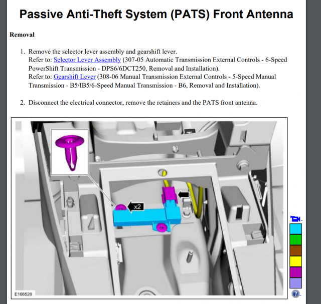

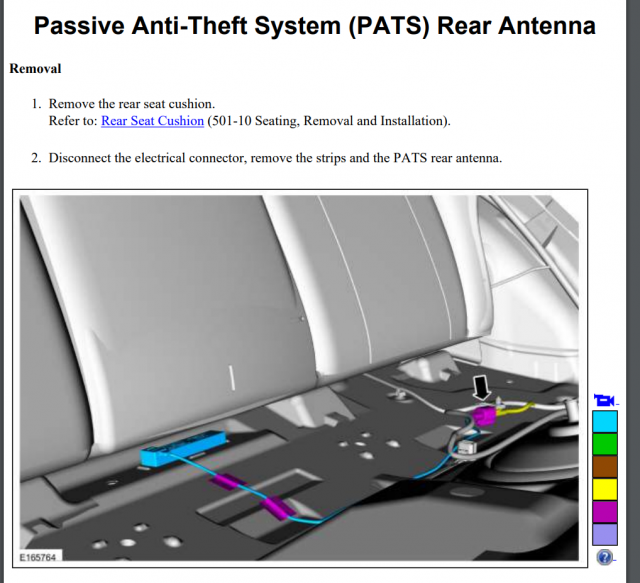

Okay, so, there should be 3 sensor. 1 under the rear seat, one under the arm rest, and one above the shiter, behind the heated seat buttons, it is easy to miss, as it is put on the inner side of the plastic.

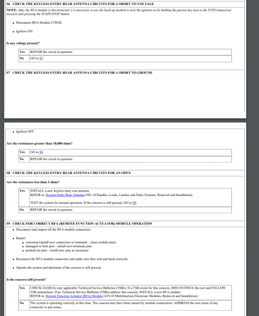

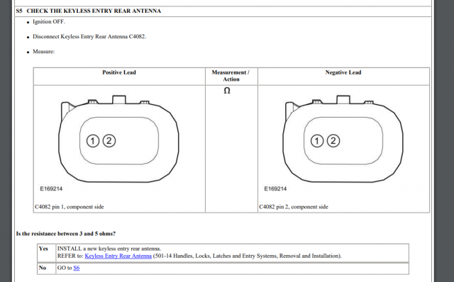

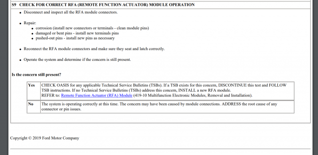

Today I checked all 3 again. The service manual says that the sensor should have under 3 ohm resistance, if one of them is between 3-5 then change that. For me the front 2 was at 2.2 ohm, and the rear was 2.5, I guess because of the long pigtail.
I will contuine with the checking later, sadly the rain started, so I had to stop...
