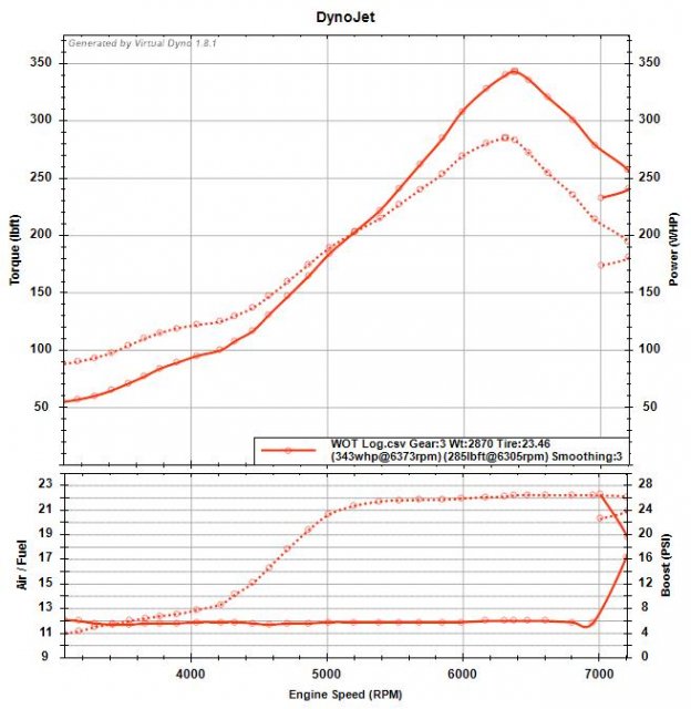

So we Jason and I have hit a minor snag with voltage to the lowside pump. Hes trying to be careful as this car has a returnless fuel system and doesnt want to overflow the hpfp. So I saw this today on a WOT log I ran through Vdyno and um... this makes me not want to do a wot run again haha. revision.jpg

So we Jason and I have hit a minor snag with voltage to the lowside pump. Hes trying to be careful as this car has a returnless fuel system and doesnt want to overflow the hpfp. So I saw this today on a WOT log I ran through Vdyno and um... this makes me not want to do a wot run again haha. View attachment 43797
This log is a little messed up cuz I blipped the rev limiter that's why the afr got messed up. It's not actually harmful at the end of that graph it's just throttle let off.

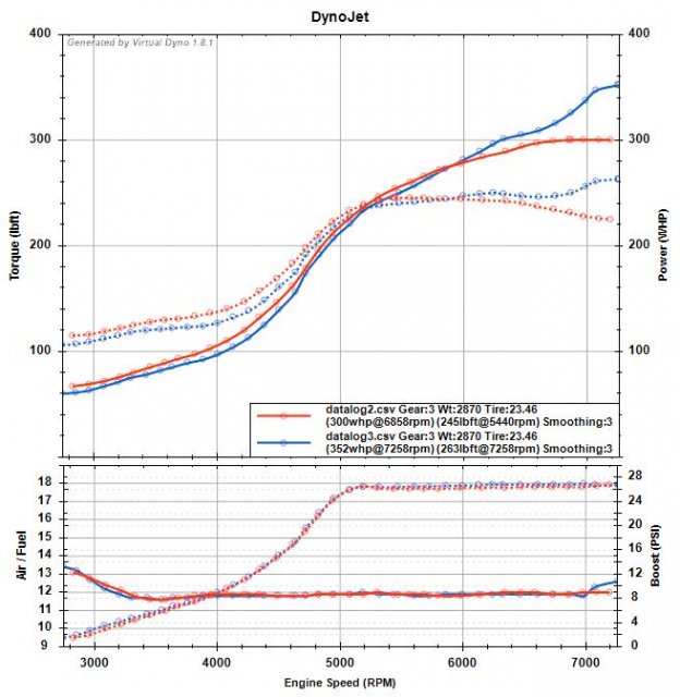

Newest Pulls. Starting to push the hp out further down the RPM. Currently running 27 LBS on 93 octane. Not sure of the timing, but every rev is still adding max timing which is 3.5 degrees. Spools hitting max boost around 5k rpms right now. Next tune will be raising the rev limiter to 7500. This is still without upgrading the in tank pump also, I put the stock one in after the aem failed, haven't put the dw in yet.
