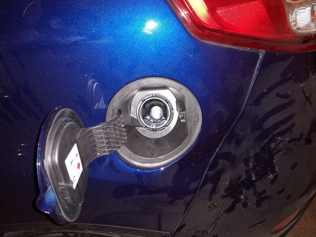

I was in a very small fender-bender today, just a tiny impact to the left rear behind the filler neck. Now I'm getting paranoid, because when I look in the gas filler hole, I don't remember that silver piece being there. Maybe it pushes out of the way when you put the gas pump in, but I can't push it out of the way with my finger, and I haven't noticed it before. Now I'm worried that maybe I've bent something in the filler mechanism. I'm referring to the round silver piece in the very center where you would put the pump nozzle.
If someone could look in their gas filler hole and just confirm that that silver piece is there blocking the opening that would ease my mind greatly, thanks everyone.
If you can let me know if you can move it with your finger that would be helpful too. As I think about it, I guess if it is supposed to be there it's what seals the gas fumes in the tank so it wouldn't be easily moved.

Thank you both so much for your quick responses, and especially for the picture and for going outside in the cold. It's just damn upsetting when you crunch your car, even a little bit, and this at least gives me one less thing to worry about. If I couldn't put gas in it I wouldn't be able to drive it until they fixed it.

Now I know the flap is supposed to be there, but I'm still concerned that I can't push it out of the way with my fingers. I'm going to head to the gas station soon and hopefully the pump will still fit in there. I'm hoping that it just takes the additional heft of the pump to move the flap.
Can anybody push theirs out of the way with just your fingers?

No, a finger won’t do it.
You can use the funnel that came with the spare to see if it’s still functional.

I went to the gas station, and the nozzle went in fine. It looks like it releases two tabs on the side which then allow the flap to open. Ford says that their capless gas tank is very resistant to gas stealing, and I guess this is part of the mechanism to make that happen. If you could just push it open with your finger it would be easy enough to siphon gas out of it.
