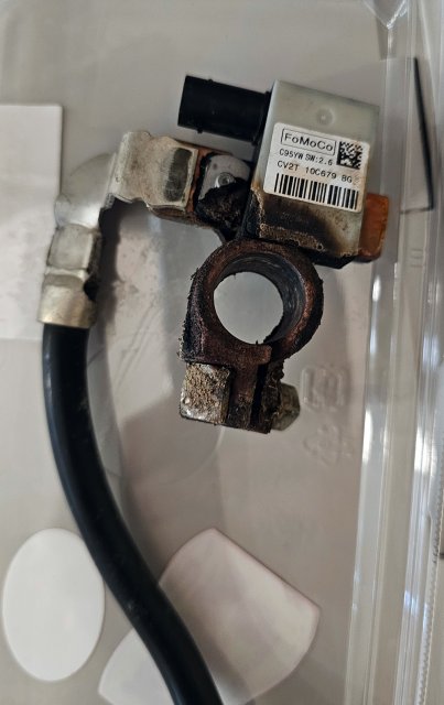

This is what my cable looked like when I replaced the battery (3.5 years, 25k miles). I figure I should get a new one just in case, though I didn't have any obvious electrical issues or codes.
Was that original battery over charging at all??
Was the casing swollen on the sides, or bulging at all when you replaced it?
That terminal/module almost looks COOKED, but I guess that could just be the 'normal' acid erosion of a flooded lead acid battery. [dunno]

No indication that anything was wrong with the battery, other than the visual corrosion of the terminal. Battery was 3.5 years when it died so I don't know if it was premature due to this condition, or if that's just how long the OEM battery might last in this car. I've seen another user post their battery cable looking very similar to this in a different post.
I've had issues (which seem to be common) with the terminal getting corroded. Cleaned everything with baking soda maybe 1-1.5 years ago, which left the terminal looking an odd color/finish - I'm assuming since then the continual acid erosion has caused this "burnt" appearance.

Yeah, that's another reason why I spend the extra coin and only buy AGM batteries now. [wink]
Both of my cables are in factory perfect condition, even after 7 years of ownership.
