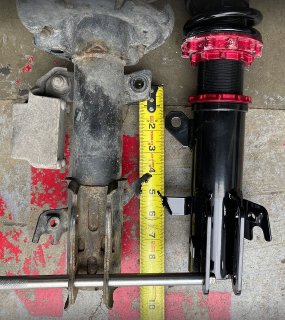

The installer expressed concern that the sway link mount is quite a bit lower than on stock struts and wonder if it will cause any contact since we're reusing stock links.
Initial impressions from the first short drive from the shop are neutral; I can't say I notice much difference in handling on the road yet. Sharp pavement edges seem to be transmitting more acutely but everything else is dampened well. On the other hand, the tire drone (on RE71RS) is significantly more pronounced. Also getting a fairly prominent clunk going onto the driveway curb at an angle, one wheel at a time. Could this be sway bar hitting things due to a different mount height?

Maybe grab some adjustable links at some point and lengthen them 1.5"?
Yeah, I'll probably do that. What took me aback is judging from forums nobody really indicated that they needed custom sway link lengths for our car (as opposed to for some other Meister kits that come with different sway links included, which I imagine is done for this very reason)

You can buy adjustable end links if you want . That would b more for swaybar tuning lots of us run MeisterR’s no has ever had issue mounting the stock end links and using them. Though ya like I posted the noise is definitely from one of the two things I suggested checking. Been there done that.:LOL:

Currently using stock end links with the MeisterR's and have had zero problems in the last 58k miles
