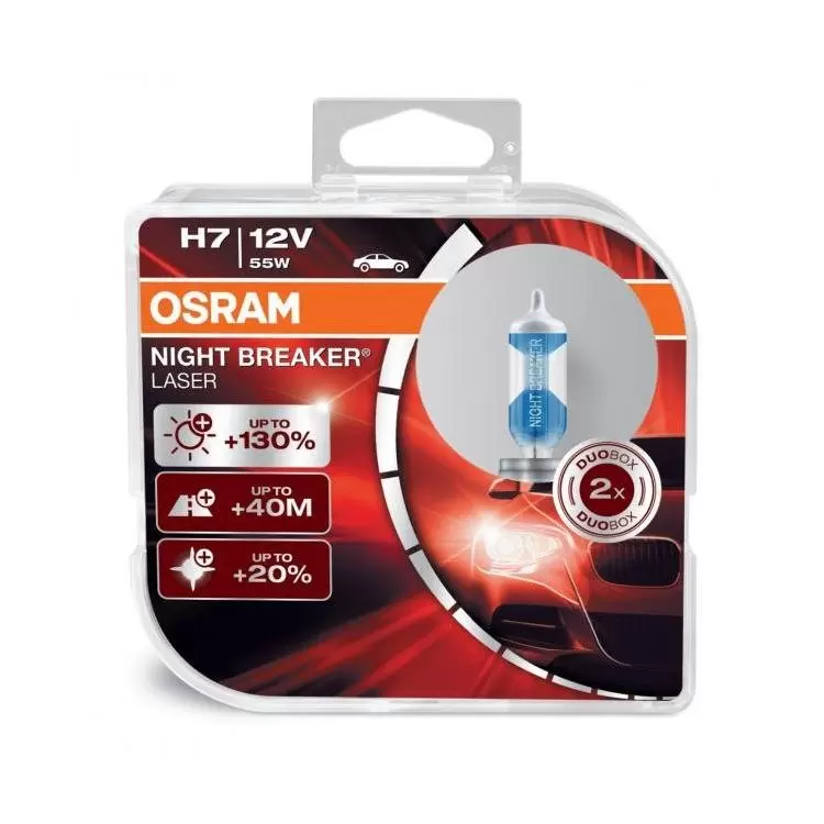

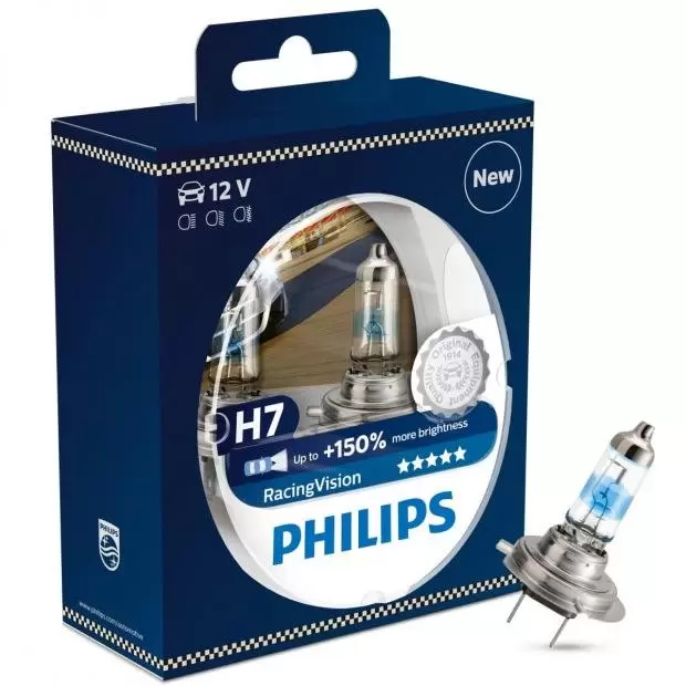

For anyone that wants the absolute brightest headlight bulbs, go with the Osram Rallye H7 bulbs. I ordered a pair and will be experimenting, as I don't know if I'm 100% satisfied with how the HIDs are performing.
These bulbs output 2100 lumens compared to the average 1500 to 1600 of traditional H7 bulbs.
http://store.candlepower.com/osraulhiouh7.html
Other mentions
Philips RacingVision +150 (2200-2300+ lumens)
Osram Night Breaker Laser (2000 + lumens range)
Vosla Plus 100 (similar lumens to Osram Rallye)

The only thing with getting brighter halogen style bulbs is that they typically generate more heat and the life span of the filament tanks. Just food for thought....[rockon]

The lifespan is only about 50 hrs less than comparable bulbs. Either way, wanted to give the option to those who want the best performance in these lights.
