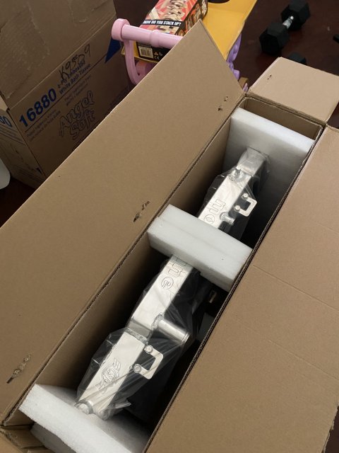

You in Arizona? Mine has been overheating at idle here. So I ordered this for the fix.

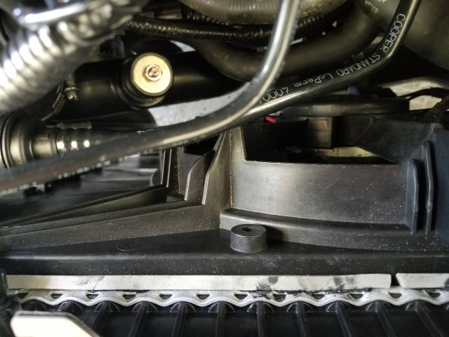

I had a spec v sentra that I put a turbo (t3t4) and it always would overheat at idle in traffic when running the ac. I bought an all alum inum radiator, 2 high performance Spal fans, and lower temp mishimoto thermostats - still overheated. I put foam seal tape around the radiator fan shroud forcing more air flow through the cooling fins. It worked. 20200513_103424.jpg

I had a spec v sentra that I put a turbo (t3t4) and it always would overheat at idle in traffic when running the ac. I bought an all alum inum radiator, 2 high performance Spal fans, and lower temp mishimoto thermostats - still overheated. I put foam seal tape around the radiator fan shroud forcing more air flow through the cooling fins. It worked. View attachment 32317
