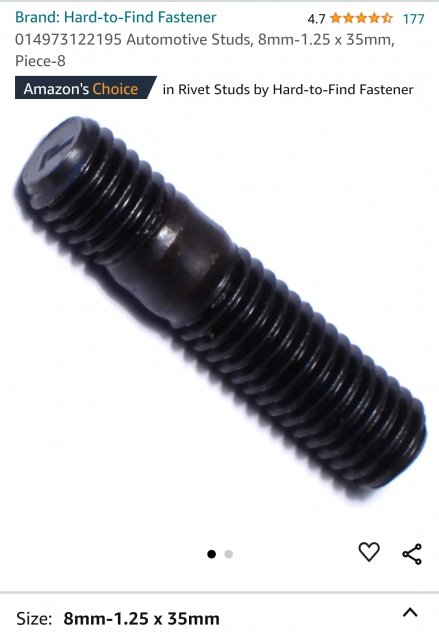

My s280 install got loose on me. Use these to keep the install from backing out. Replaced a lost stud too.

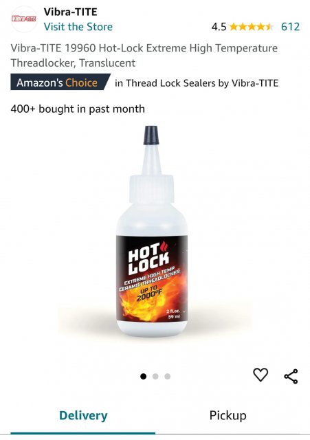

1. Prevailing torque locking nuts. All metal, not the ones with nylon.
2. High temp thread lock. Got it on Amazon.
So far no issues!
