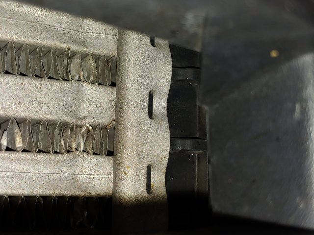

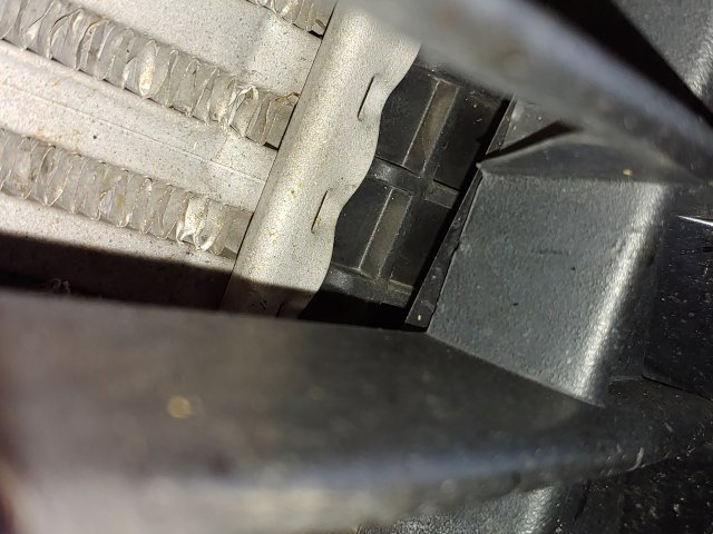

Below, is that the plastic sides that were mentioned?

You are correct those are both stock.
The exhaust makes no difference on these cars really it's just for noise. It was the first thing I did because I hate stock exhaust systems. The intercooler and accessport are the best upgrades you can make. I'm doing my intercooler upcoming spring.

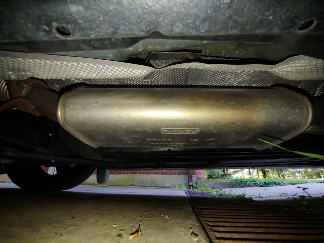

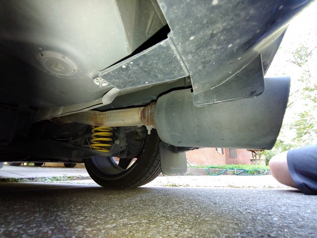

Ok good to know. So i have seen a FoST in town and also heard several stock FiSTs on video and i don't think my car sounds like they do. It seems louder and i can definitely hear the whistle of the spool and the blowoff when shifting. is this due to the CAI ?
I also think my car exhaust sounds louder, although i admit video and real life are hard to compare. But could it be due to my "muffler" ? I tried looking it up and maybe im wrong, is this called a muffler delete? Meaning it does less muffling and allows more noise to exit the pipe? 20190730_160857.jpg 20190730_160913.jpg

Yeah it looks like the last person deleted the muffler and put some magna flow tips on the car.

Ok well im good with that then. I like the sound of it as is fairly well, it's has a rather low growl to the note. I do love that whisle and whoosh though lol. So i have a clear direction at least, AP and beginner tune and then scrape up enough to get the FMIC and another tune.

Yep they did a muffler delete you still have the stock resonator in the front. The cold air intake that you have will definitely make more noise. I have the ST200 airbox.
