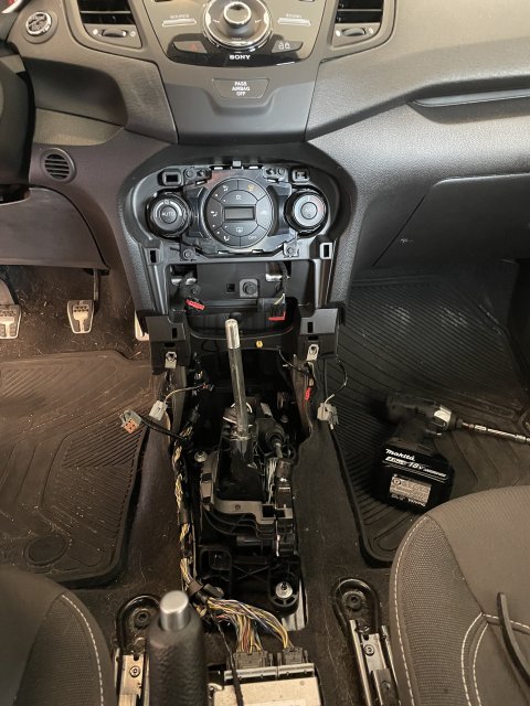

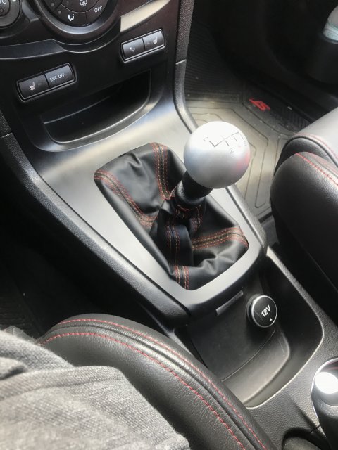

Yes, you have to go below the shift boot. The plastic trim piece that surrounds the shift boot and climate control parts just pops off. Apply very firm but even pressure and try not to lose any of the clips that hold it on. I put a titanium one from WC Lathewerks and it’s excellent, especially paired with his shifter extension.
Note that you don’t have to take out the whole console like this just for the shift boot.
https://www.lathewerks.com/focus-rs-reverse-lockout-ring.html

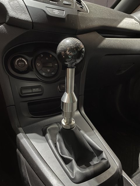

I'm running exactly that in their wrinkle black finish and it's perfect!
Just a question, did it come with a narrower/smaller spring? I noticed there's a little spring in the reverse lockout, and I'm not sure if it would fit in the narrower one.
EDIT: Ah, I see on their website it includes a narrower spring for the "Subaru style" lockout. Great! Well I think I can handle this, although I'm going to install the Whoosh short shifter kit first. ;)
