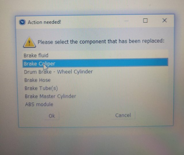

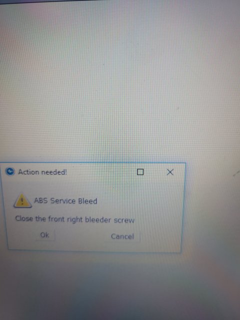

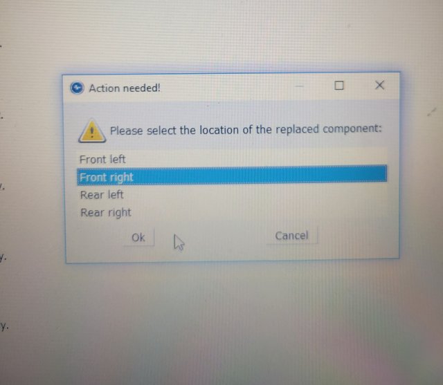

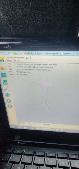

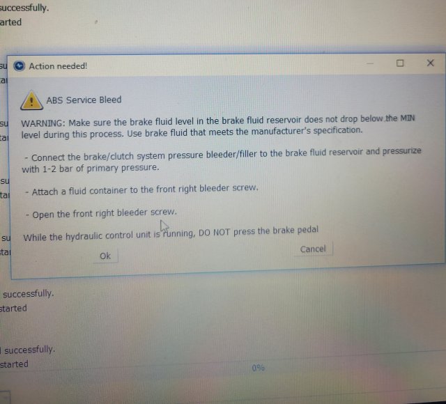

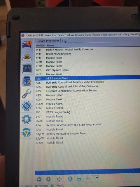

Did this tonight, screenshots below. I pulled my front brakes and added a Whoosh kit with stainless lines. I did this procedure 3x per side in the back, 2x per bleeder in the front (8x total) and went through 2.5 bottles of RBF600. Pretty self explanatory below. Let me know if you have any questions. Most important step is once you click "OK" after opening the bleeder, be ready with your brake fluid to keep the reservoir topped off.

In an ideal world, yes you'd have two people. I didn't use a pressure bleeder or anything else. I opened the reservoir, filled it to the absolute brim, click the button, then walk over and fill the fluid as it pumps in.

I dowloaded forscan (free) i found the abs bleed but only told me to hold the brakes as it "cycled" did not show me anything about bleeding the brakes,
Will try to purchase, but i dont see the lifetime purchase.
Make sure you pick "caliper" on the screen that asks you to pick which part you replaced. There was a lifetime option when I bought mine but maybe that went away, haven't checked.

Do not see any caliper instructions.. just have a "abs valve bleed". Just a few exercises of pressing and depressing the brake pedal while i hear the abs pumping.. (does not tell me to or specify to open any bleeder screws, not sure if its just cycling within the system?)
Tried it a couple of times and also tried it with a bleeder screw open.
Ended up using a motive pressure bleeder, had trouble even getting any fluid to come out of the rear calipers at 15psi very very slow to get 1/4 quart (15min) . Did1.5 quarts of dot 4. Car feel like its at 80% of braking original power. Still spongy.
Might have to bench bleed the master when i get a chance.

Bpjr07: did you ever get your brakes sorted out? Were you able track down why your ABS service bleed procedure was different from Jabbit's?
I saw discussion with TyphoonFist on the Forscan Forum about some US cars not having or allowing the individual component bleed, and Forscan fixed it, but I couldn't get a final answer.
I see that Jabbit's ST is a 2019. What year is yours? Maybe that makes a difference in what procedures have been programmed. Also, maybe you need the extended license ($12 per year) and the cable Jabbits provided the link to above. That's the one Forscan recommends. For a total of $70, I might order the cable and get the extended license, even if it only does the basic ABS bleed and not the individual components.
