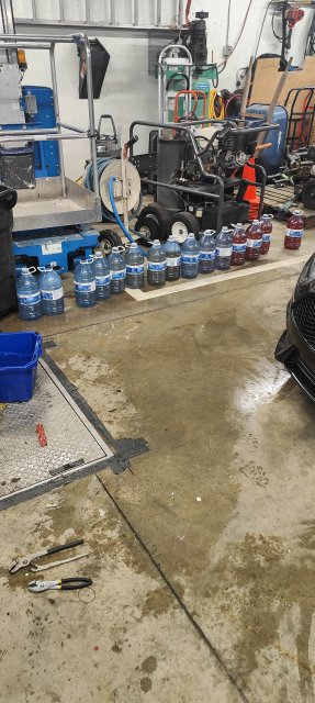

How many bottles of distilled water do you think a coolant flush takes.

When I did mine, 8 gallons of distilled ended up being plenty to clear out the system and fill up again (one drain, one flush, one rinse, one fill), but mine was also in pretty good shape.

Man I only had 30,000 km on there and the amount of sludge that fell out of the system is mind blowing. Fuugh dex cool!
Switched to Honda type 2 we'll see how it goes.
