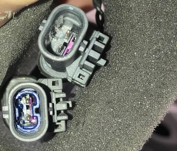

plz ignore my ragged-ass looking finger, I accidentally got electronics contact cleaner on my hand and its wreaking havoc with the skin lol
The upper one is the plumb-back (no directional insert) and and the dual port (blue directional insert).
If you look at the outside of the plug, where the plug clip actually engages, it's ambidextrous, but the pins inside the connector are not centered.
With the blue insert you *couldn't* do it backwards, so I didn't pay that much attention when switching to the plumb-back. Oops.
