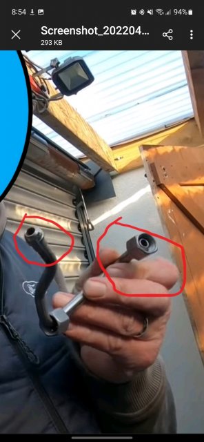

I've seen several videos now on the Fiesta ST high pressure fuel pump replacement, and have pulled up images of the replacement line to get an idea of the line ID dimensions. I am 70% sure this is the case with our cars where one end has a larger ID compared to the fuel rail end.

Well, this thread is dead. The Bosch injectors thread linked a YouTube video of the install and in one of the shots you get a clear image of the hard fuel line. The line looks wide open.
