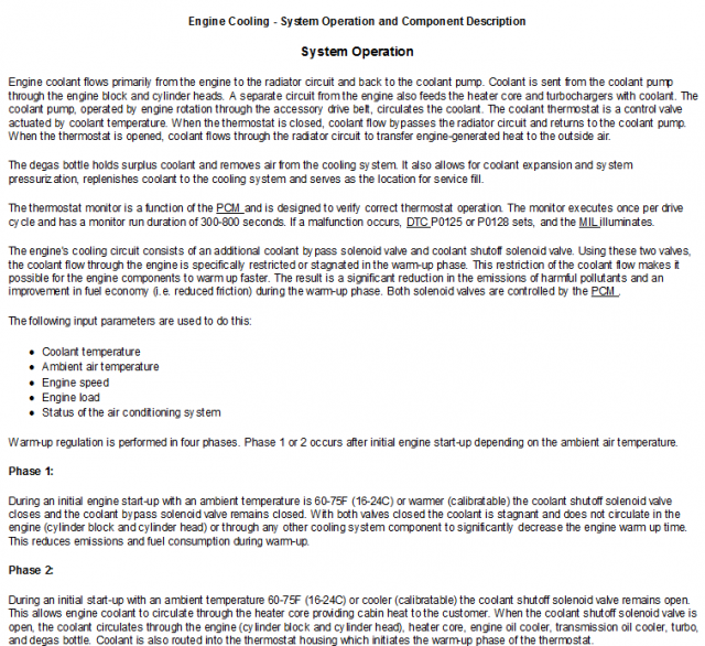

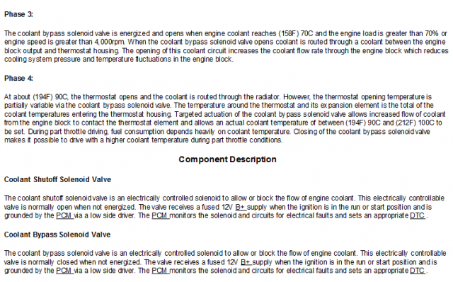

Prior car had an overcooling issue to the point could barely get any heat out of the core. It eventually got bad enough that it would go in/out of open loop mode; marked by very sudden high idle only seen with cold starts. This was an EEC-IV (pre OBD) system.
Newer engine control designs in general, seek to control temperatures *MUCH* more tightly than older ones.
For the motorcycle with an older design, I can see as much as an 18MPG swing just based on ambient temps. Just covering the radiator gets much of that back. The newest generation of my same bike, runs the engine wwaayy hotter. (emissions)
