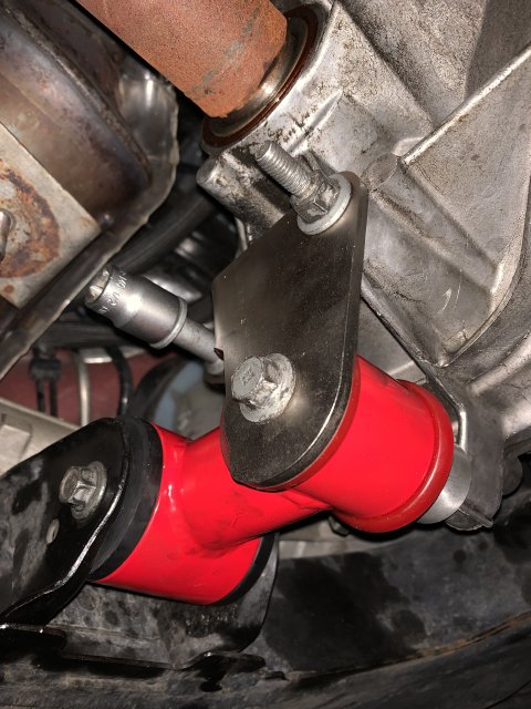

Ok so i was working on installing an AWR RMM.
the two main bolts were stuck but easy enough to get loose with some wd-40.
now my problem is the the stud that holds the bracket, park number W716047-s442
now i can order a new one, even tho i wouldn't want too, the "overnight" shipping would still take 5 days, and cost at the lowest 40 bucks for a 12$ bolt
Now i stopped myself from get two carried away and let it soak in fluid for the night and put the rest back together.
im looking for ideas on how to extract this stud without causing two much damage
(to put it into perspective i was using a cheater bat on my 1/2 inch ratchet and honestly think it broke some ratchet teeth)
i could buy a slightly smaller breaker bar because mine doesn't fit under my car while only on jack stands
my main problem is the bolt is now slightly rounded off and sockets just started to slip off.
this stud just seems to be really seized and cant find a way to get at it.
any and all recommendations would be helpful

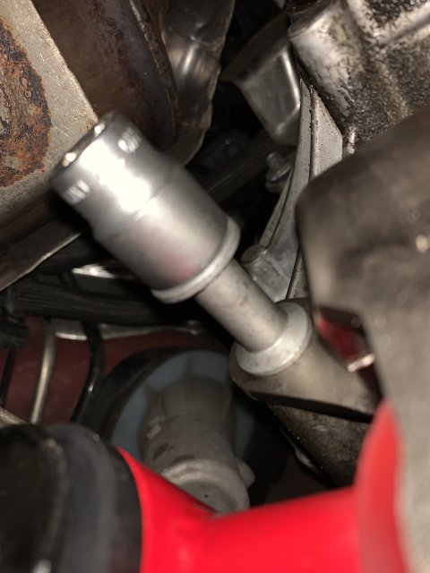

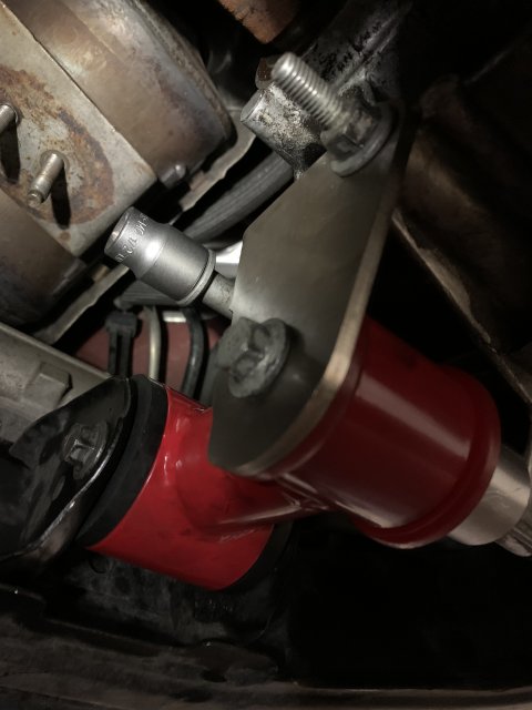

Update:
I went to harbor freight this morning, and picked up some bolt extractors on my way to work. I get the SAE set as I didn’t wanna take a chance of the bolt riding off even more with the 13mm. I
I also bought a 17” breaker bar as the one I have is to too big. This one is still tight under the car on just jack stands but it worked.
bolt came right off no problem and I ended up filing the bolt head so it wasn’t as rounded, and it torqued just fine to 48nm.
little work on the bolt saved me a lot of time. When I called my local ford dealership, they said it would take over 2 weeks to get. So I just went with it my way.
I index up also replacing the FMIC since I had it on me, and that was a pain in itself but no problems afterwords there.

I would have, and actually did stop in ace to see it’ll they had anything similar but I was wrong about what bolt was stripped. It was the innermost one, that connects to the downipe bracket. See the picture with the socket on the bolt. They didn’t have anything close, so I had to make due. I feel I could have done better, but it works and the mount feels great.
