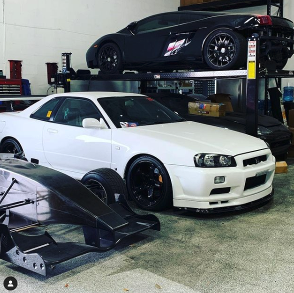

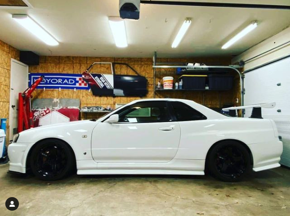

ps, R34 pics below.

Beautiful R34. That's one of my dream cars. But seeing where Skyline prices are here in the US, the R34 is going to be insane when it reaches 25 years.
