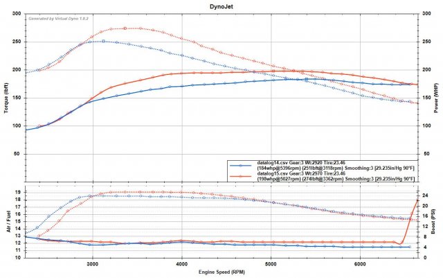

@Raziel510 ......I think I am following the same path as you, and I have found myself progressing through these levels in like a week, LOL

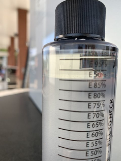

Right now I am all stock on the DizzyE30 tune, and this was clearly enough better than the 93 (see the Vdyno below....Not sure on the absolute magnitude of these numbers, but I've been looking for differentials) that I will stick with it (as E85 is available five minutes from my house) so its worth the small bit of extra effort to mix the fuels. It's pretty simple in my case as here E85 actually tests at 85 here, and the 93 comes out between E8-10. So 3-4 gal of E85 to a tank does the trick.
