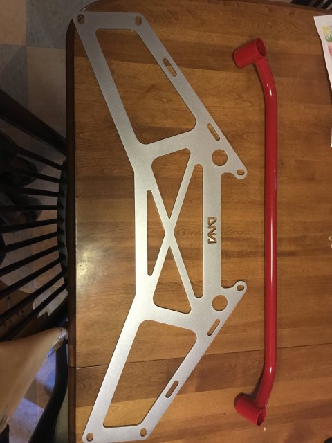

Does anyone on here have a DNA bottom subframe brace and if so what hardware does it need or is there existing hardware under the car to use? I know for the front 2 point brace you use new lower control arms bolts since they’re stretch bolts.
Was in the middle of an oil change so was able to look and mostly confirm my suspicions. You reuse the hardware that is already on the car. I looked at the pictures from a UK vendor and the bolts used look identical to the ones that are already on the car, here's the link:
