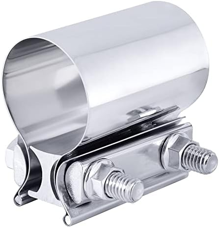

Find this (exhaust sleeve or manchon d'échappement en français) if the area where the old exhaust was cut is straight. It will be the cheapest alternative and you'll be able to install it yourself. Welding back the old exhaust is a waste of time in my opinion.

Fast forward, I installed the exhaust sleeve and it seems to be working perfectly for now. As soon as I pass the test I'll swap my exhaust so it's basically a very short term thing BUT, I came across an "exhaust paste" while shopping for some stuff and I wondered if it's worth it, even more as a general question since I really don't think they'll be looking for the smallest leak (might be wrong though :unsure:). So I guess it'll help sealing it better but is it hard to remove afterwards ? That would be my ultimate question. Thanks fellas
