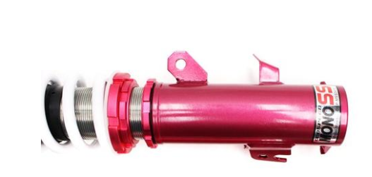

Update - they go much higher than I thought. You can extend the entire front coilover length by unscrewing the shock and spring assembly from the base.

Update - Im stoopid lol. I was fighting with rub last night while driving a buddy around so I took a look to see what I could do this morning. The entire spring/shock assembly unscrews from the mounting base on the fronts. Once you lock up the spring compression nuts you can use them to unscrew it from the base to raise/lower. It has a jam nut on the bottom to lock it when your done. I edited the post.

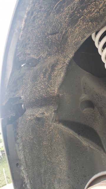

Stock 17x7 205/40/17 on an et40 wheel. The rub honestly wasnt horrible, it ended up being the top of the wheelwell. Over time the wheels would have made their own clearance but I'm not about that lol. I have a 2 finger gap all around currently with front springs preloaded a bunch and dampening all the way hard for now. Here's a picture of the rub
