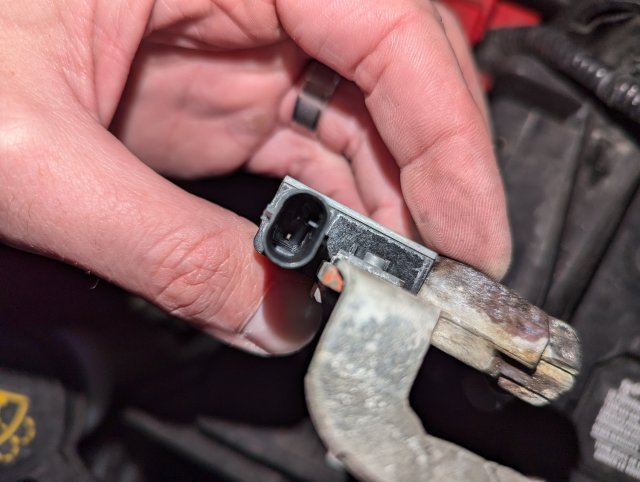

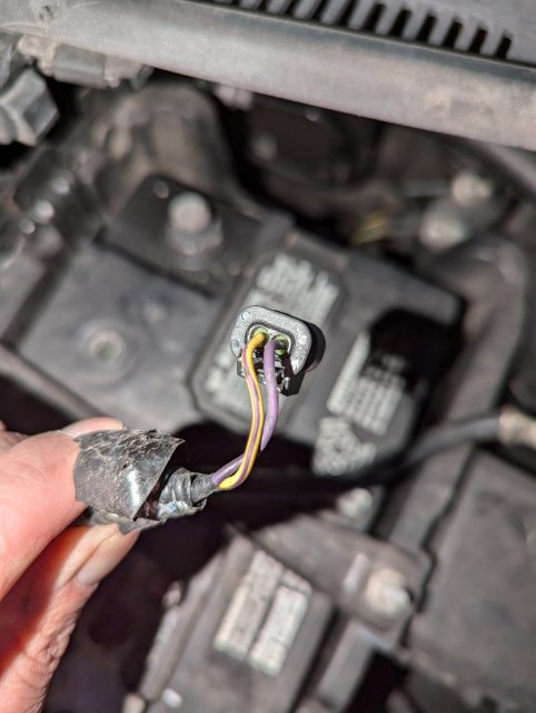

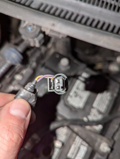

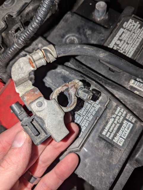

I included some pictures of the battery current sensor for reference.
Has anyone here experienced anything similar? Any recommended next steps?

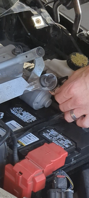

I've got multi meter I can dig up. Looks like the wiper motor might be buried in there.
Are the similar/related things to check before digging that far in?
Not really.....I can get the cowl off in about 5 mins I've had it off so many times. It should take a you about 15-20 minutes first time.

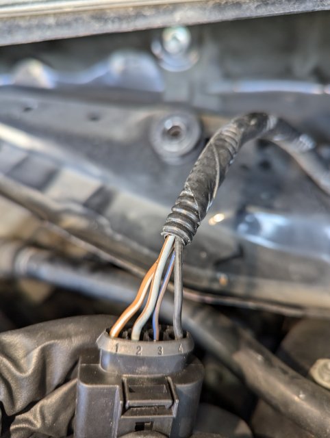

Okay, here are the results with the multi-meter.
These Tests are using ground on the body of the car (same ground the battery is on).
Pin 1 (orange & white)
- position 0 = mv
- position 1 = mv
- position 2 = mv
- position 3 = 13.9v
- position -1 = mv
Pin 2 (Grey & Orange)
- position 0 = mv
- position 1 = 13.9v - only for 10-15 seconds
- position 2 = 13.3v - forever
- position 3 = mv
- position -1 = 13.9v - only for 10-15 seconds
Pin 3 (Black & Blue)
- position 0 = 13.3v - forever
- position 1 = 13.3v - forever
- position 3 = 13.3v - forever
- position -1 = 13.3v - forever
Pin 4 (Black)
- position 0 = mv
- position 1 = mv
- position 2 = mv
- position 3 = mv
- position -1 = mv
My assumption is that Pin 4 (black cable on the harness) is the ground cable. If I have the multimeter's negative probe on this pin, instead of the existing ground... I should get the same results, right?
