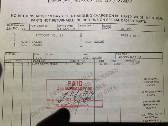

Does anyone know the Torque spec for the rear torsion beam brace? I found the one for the two point front chassis brace which is torque both bolts to 46 lb-ft then an addition 180 degrees of rotation.
Or the Ford OEM control arm bolts part number? I would like to replace them when installing the 2 point chassis brace as its recommended once the bolts are removed as they are stretch bolts.
