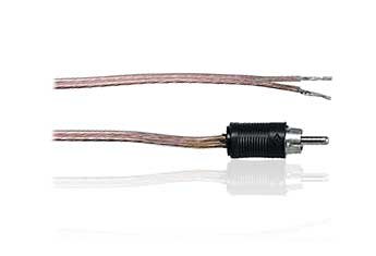

Also, for people looking at cabling options - this maybe the most strait foward:
Since a a lot of the cameras have a female RCA output, you can use one of these and add the pins for the harness connector, on the end of it - after routing it up to the monitor and through the plug.
https://www.amazon.com/gp/product/B00123327C/ref=ox_sc_act_title_2?smid=A1DAVWUAC8VKU5&psc=1
Another option, if you want to insert the pins from the front of the connector, to keep them from falling out, use one of these after pushing the pins through with a small portion of cabling on the end of it.
Just use a male to male rca patch cable from it to the camera.
https://www.amazon.com/gp/product/B00ST2KHL8/ref=ox_sc_act_title_2?smid=A15SWSXNAYIVZ9&psc=1
Do back ups, do screen shots and only make the change to that section. Have a good battery (car running is fine). you will not have any issues.
As for the connector eitehr will work BUT fishing the RCA plug in the dash and want not would be a real pain. Easier to cut and re splice.
