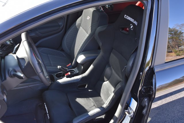

So this thread was good timing as I was about to do my driver seat install at the time. It's took some time because of slider issues from Corbeau (didn't send me the correct parts). But after following the Sparco Seat Install + Airbag thread, my Corbeau FX1 Pro seat is in. I opted for the microsuede option instead of cloth.
The photo doesn't do it justice, the shoulders of the seat are within the car by a few milimeters. It's a tight fit, but not as tight as I expected it to be.
