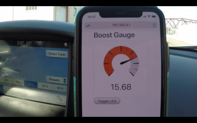

I'm going to try calculating Boost, I also have an idea for a quick way to display this data on an old cell phone over wifi.

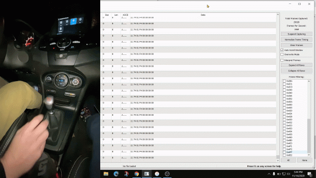

I'm not 100% sure on how to make an update to this that is easy to follow.
In short, I have found the active gear in the CAN data. So I don't need to calculate it as I talked about above.
I don't have it on the display yet, but see if you can see it changing in the filtered CAN data as I shift. It's not lagging much which is pretty cool as I was using WiFi to connect to the OBD2.
