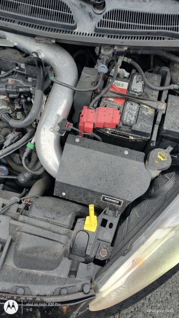

You are going to need the complete stock airbox and crossover tube as well. Check your downpipe to see if that is stock.Plus you are going to have to delete the Sound Symposer block off and find a stock Sound Symposer tube. That's a big problem of buying an out of state car sight unseen. When you are ready to have it re-tested. Go back to the same shop and the same tech. That way with the stuff he found on the visual, as long as they are done, he should pass you on the visual. If you go to another shop and another tech. He may find something that the first tech missed and then you are going to have to find those stock parts as well. Good luck.

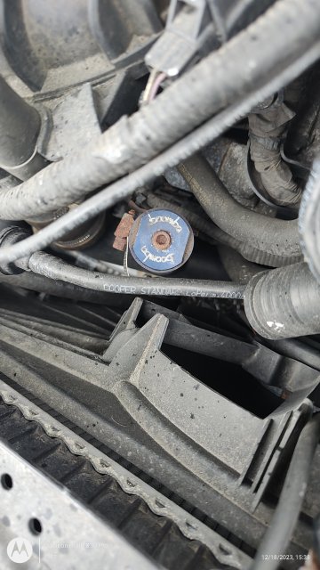

hello sir, did you see the first photo I send to you?
What is that
The mishimoto brand I fond a carb number already but the first one name with boomba didn't figure out what is thatšŸ˜­

If you found a carb sticker for the Mishimoto you need to show it to the smog tech as far as the Bomba symposer delete goes there is no smog sticker for those . You have to put the stock factoey sound symposer box back in so it looks stock.

Sorry new problem here... Any advise for find a stock sound symposer? I been searched fordparts webside and didn't find out ;/

I wonder if replacing the whole sound symposer assembly would be that big a deal. After all, the visual giveaway is the Boomba part that sticks out and is visible. I wonder if something non-descript like a black plastic plug would be enough to get by on.

Finding a Symposer will likely prove easy because many get rid of these things to get the droning sound out of the cockpit. Odds are fairly good someone on this forum will give one to you for nothing more than the shipping charges. The only hiccup in this is you have a 2015 and Ford may have used a different symposer on the early ST's versus later ST's.
