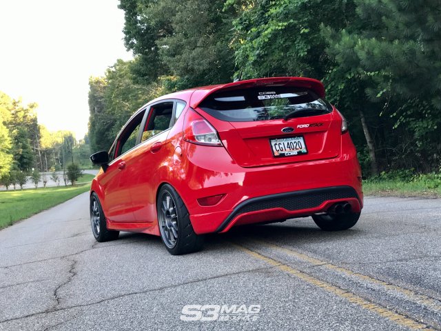

I finally figured out what I wanna do after hours and hours of research, but need to maybe see pics and I need to know what lug nuts. Lol
Going with Konig Hypergrams 17x8’s with 215/40/17 Falken RT615’s.

Pic for example of hopefully something close.

Those tires tend to run very narrow in tread width.
Most likely they will not rub on Swift springs even without any fender massaging. [thumb]
