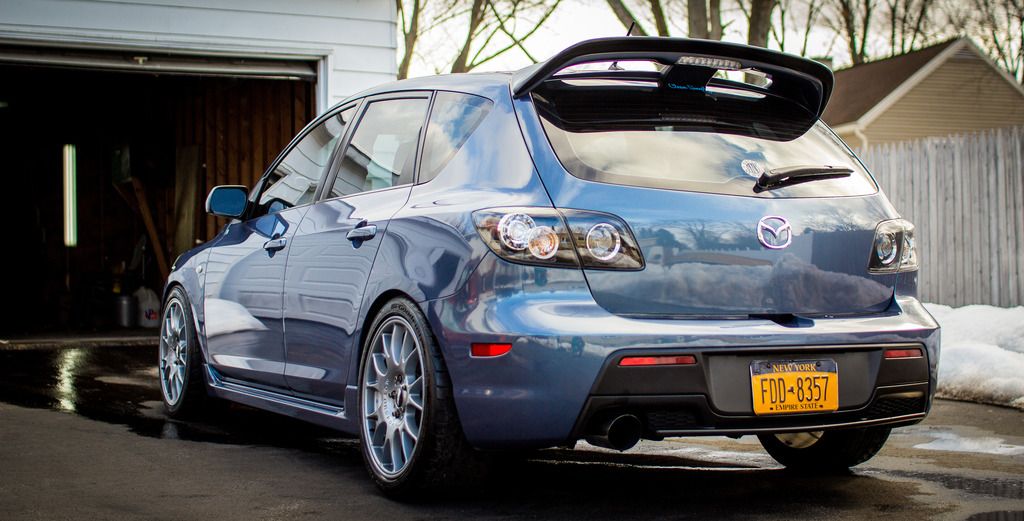

I skimmed through all 21 pages to find my info with no luck, these are 17x7 ET 40 (4x108) 73.1 Centre Bore
I want a little bit more flush look, otherwise these are exactly what I want.
They have an option for 17x7 ET 25 (4x108) 65.1 Centre Bore, but on the first page it says we can only go 35-47. So et 25 will not work correct?
If I went with the ET40s, what size spacer would I need to get a nice minimal poke flush look?
Lastly hubcentric rings. Im a tad lost on what they're for. Im assuming they fill the bore to a closer to stock fitment?
Thanks for any input on this! [tongue]
A little wheel porn!
[woot]
14,568
7,090
^^^Much more 'flush' than that pic, and you will be outside of the fenders/wheel wells!
I would not go more than a 5mm spacer, but maybe other 'ultra flush' fans on here will chime in with a different opinion/advice. ;)
Yes, hubcentric rings are for adapting a larger than your car's factory hub flange size wheel EXACTLY (or at least to within .1 mm of) to the factory hub flange size.
I would suggest aluminum alloy ones over plastic, especially if you ever plan to open track your FiST.
