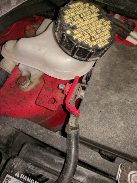

To give an update on my weird problem, I have good news and bad news. The bad news is after I changed the key's battery the problem was not fixed, it was just temporary well behaving. So week after week it was like, sometimes the car starts perfectly; sometimes it starts almost perfectly but makes an extra noise; sometimes does not start nothing happens when I push the button so I hit the steering wheel and then it starts; sometimes I have to sit in the car and keep hitting the steering wheel while I rapidly press the button and it starts after 15 minutes; really annoying it brought me near despair cause I'm not a mechanic I hate fixing cars. But then out of desperation I open the hood and look at the battery and I notice the ground cable is not really well screwed to the frame. (On the photo you can see this). So that's the good news, it seems to have fixed the problem.
I hope this can help someone, before you go spend money at the car repair.
Other diagnosis symptoms I had:
-when I hit a bump some weird electrical thing happens like a beep or a light.
-on the highway no bumps the car drops off cruise control and everything shuts off for one second then restarts , that was scary .
I had a problem like this on my E36 M3. I had a ground problem. When I was able to find the bad connection, I didn't have the problem anymore. It freaked me out when it happened though.
